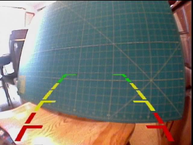

    The moving grid lines show you where the car will go/be based on the direction the steering wheel. If the steering wheel is straight, the grid lines are straight back. If the steering wheel is turned, the grid lines hook left or right. In my setup, the camera generates the grid lines. Attached is a picture from the camera when I was testing it out and it was not attached to the prius. You can see the grid lines.

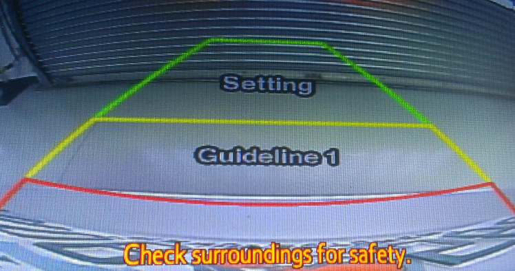

    This is an extract from the accessory installation document for Part Number:00016-32027, Rear Camera For Display Audio Kit.
    Prius 2014 Rear Camera For Display Audio
    Programming The Camera Guide Lines
    This backup camera has the capability of displaying no guidelines, or any one of a selection of up to 9 different
    sets of guide lines. Set the camera to GUIDELINE 1 using the programming sequence below.
    For vehicles with Smart Key:
    When you press the START button the first time, it will to go ACC mode. The second press will switch
    the vehicle to ON mode. The 3rd press will shut it off.
    1. Leave your foot OFF of the brake pedal through the programming procedure.
    2. Double press the START button for the “ON” mode. After 3 seconds, press again to shut off.
    3. At the 3 second mark the Toyota logo will appear on the radio display. As soon as this
    appears you can shut the vehicle off.
    4. Once off, wait 1 second, then repeat step 1-3 four (4) more times for a total of 5 ignition cycles.
    5. Upon the 5th turn-on, leave the vehicle on and immediately shift the vehicle into reverse.
    Please refer to the timing diagram below.
    The screen should now display “Setting” and start to cycle through the different options for guide line. Once the
    screen displays the setting for GUIDELINE 1 quickly shift the vehicle back into park and shut off the key. This will
    store the last set of lines displayed on the screen and set that to default. Refer to the image below. SET-AI-1078-D.jpg

    Is that supposed to work with 2015 "stock" cam? I could not get it to work with mine. Anyone else have luck with it?

    I tried this a few times with my 2015 stock Prius w/ JBL and could not get it to work.

    Unfortunately the factory Prius cameras dont have the guide line feature. You can replace the factory camera and add a aftermarket camera with guidelines. This is the way to go if you really need and want the guidelines when reversing.
