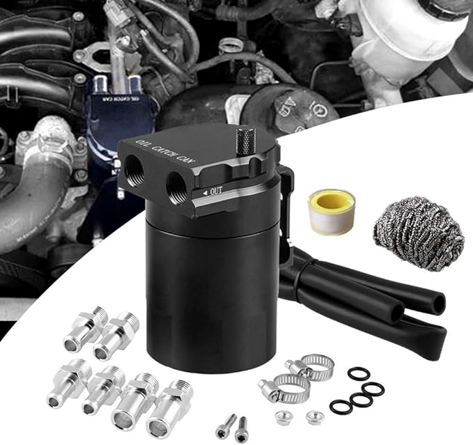

    I'll be adding this, and moving the PCV to the outlet side.

    Do you think I could install a drain valve in the bottom of the intake so I can monitor its content without having to remove the whole airbox and throttle body?
    Also, the hose that runs from the airbox to the valve cover; That's fresh air to the valve cover, right?

    Right. It should stay clean and dry inside.

    So the new engine is in and everything is reconnected except for the OCC. I need a different adaptor for the return line and a mounting bracket. I located it under where the cowl will go (for now). I'll probably move it once the cowl is back on so I can identify a better location.
    I ended up leaving the PCV where it was (for now).

    To update anyone else reading. We changed oil at 500. I didn't find anything in the OCC. I have no known issues with the engine, nor do I expect any.
