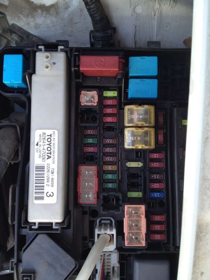

    I have a 2015 V all the dash lights are on, but no error codes, according to Dr Prius Special Features page. The hybrid battery was at 69% 2 months ago and shows 2/3 full on dash. Dr Prius shows all the cells as green. But again with not start and all dash lights on. The 12v battery is 1 year old Duracell. It was reading 6.78v, took it to Batteries plus and they said it was 11v., kept it 24 hours and charged it. Came back up to 13.3v and cranking amps was down less than 10 amps from spec. Said it was very good. So put back in the car and the same thing. Read 13+ at both the battery and at the Charge port in the fuse box.
    Does reading at the charge port mean the 125a fuse is good? I can't find it (see photo). What do I try next? A tow will be about 50 miles to the Dealer, only option I have. BTW it has been outside in - temps, was working fine, sat for the night, and would not start.
    Can someone point me to 125a Fuse, Could it be one of the fuses under the dash or someplae else.

    BTW what is under that square box at 45 degree angle lower left of the pic.? Think that is a really box that has Toyota sticker on it

    you might do better in the v forum, and you probably need a better code reader
