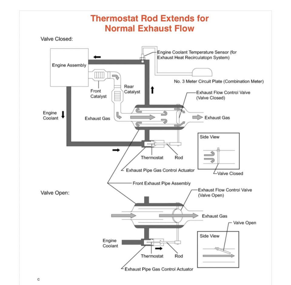

    This car is new to me and has 200,000 miles on it. It just started the issue with the coolant loss and the heat exchanger.
    I did the bypass underneath the car, that seemed pretty easy. I read that the port to the heat exchanger should be capped off?
    Well, I did that, but I didn’t secure the caps and one of the caps popped off under pressure. Should I have vacuumed or tried to blow out all of the coolant from the exchanger? It’s actually in the catalytic converter isn’t it? Do you just have to wait for it all to burn off and then cap it off? I don’t remember reading this.
  2. ChapmanF
    28,644
    18,961
    It's in the exhaust pipe, behind both catalytic converters.
    (In gen 4, the first catalytic converter is built into the exhaust manifold. So the exhaust pipe starts with the second catalytic converter, followed by the heat exchanger.)

    If the exhaust heat exchanger failed there is now an exhaust leak into your "capped" coolant lines. I would probably securely cap it.
    You should also ensure the thermostatic valve is secure in an open position to reduce exhaust restriction.

    Another member forced the exhaust heat exchanger valve into the straight through open position here:
    Need help with Custom PIDs for Gen 3 Electric Water Pump (21D7) in Torque Pro | PriusChat
    That was on a gen3 so your gen4 could be slightly different.

    You have an exhaust leak pressurizing it, more so if the exhaust heat exchanger valve is closed. On top of that the coolant is vaporizing which adds volume. But that vapor will quickly exit at the rear exhaust pipe if the cap is secure.
