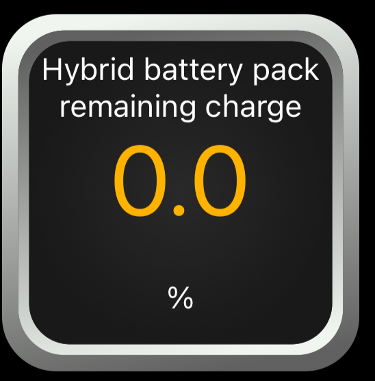

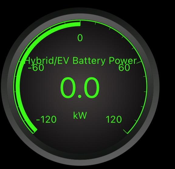

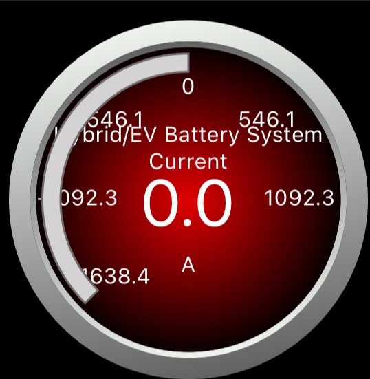

    If you are really curious you could get a bluetooth OBD adapter and one of the many OBD cell phone apps or even just look at you charge meter on the MID display.
    First I am pretty certain that the car is not starting the ICE engine to burn off excess regeneration energy because the battery is too full or too hot.
    For the last couple months I have not been driving one route where I observe similar behavior i.e. descend a couple hundred feet of elevation followed by an ascent of a couple hundred feet of elevation. When I do travel this route the ICE engine cycles on in between the short segment in between the descent and ascent almost like clockwork.
    In the last couple of months I have also been experiment with an old OBD iOS app OBD Fusion and the Carista bluetooth dongle. Here are some of the PIDs I selected to display and what I would expect to see on them during one of these brief ICE run cycles.
    First. Hybrid battery remaining charge. The car completes charging at home somewhere around 89-90%. After regenerative braking during the couple hundred feet of descent I have noticed maybe a ~1-2% increase in remaining charge. Here is a screenshot to give you an idea of what I would see. Since I am currently not connected to the dongle it reads 0% but when I unplug from the charger it will read something like 88-89%. At the bottom of the hill it will read like 89-90%.
    A couple of other PIDs are traction battery or hybrid/EV battery system current, hybrid/ev battery power and trip fuel. I use predictive efficient drive which means that for the most part on short trips the only gas I use is when the ICE cycles on to do whatever it has to do. During these brief run cycles I have noticed trip fuel consumed to be somewhere around a tenth of a gallon.
    On the hybrid/ev battery power I see a positive number indicating that I am driving primarily on electricity and similarly a positive number of the gauge for hybrid/ev battery current. Here are two screenshots to give an idea of what it looks like. Negative numbers indicate energy or current going into the battery and conversely positive numbers indicate energy/current leaving the battery.
    So if the theory that these short run cycles burn off excess electricity what should I expect to see? In my experience the car is already using electricity when the engine cycles on for a brief period. I also don't think I have ever seen a jump in battery current or battery power during one of these brief run cycles.

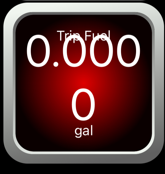

    Are you agreeing with the theory that the these short engine run cycles are to burn off excess energy from regeneration?
    I took a short drive in a hurry tonight. 4 miles one way with the OBD Fusion app running. Started at an elevation of ~525 ft, ascended to about 720 ft, than descended down to ~50 ft. I was driving in EV, Sport mode with a destination set in the Toyota navigation and in a hurry to get to the grocery store before it closed.
    The engine started after descending ~500 feet at an elevation of about 200 feet in a relatively flat area with stop signs every quarter mile or so. The start of the engine coincides with an initial drop in engine oil temperature from about 70° F to 66° F. The engine oil temperature than rises to 107° F over the remaining 3.5 minutes of the trip while using roughly 0.04 gallons of gas. In this same time period EV battery power ranged from -30 kW to +50 kW. I can not discern any patter between regeneration power and the internal combustion cycling on.
    Another detail that stands out is that the fuel rate jumps up to a rate of 1 gallon/hr 1 second before the oil temperature drops to the low of 66°F. For next ~40 seconds the fuel rate remains in the range of 1-2 gallons/hr as the engine oil temperature rises to 85° F.
    From the data I see a much stronger correlation between engine oil temperature, fuel rate and the start of the internal combustion engine. I still can't see any data to suggest that the internal combustion engine starts to burn off excess charge.
    Here is a screen recording I uploaded to youtube of the OBD Fusion app replaying the drive. I had to switch screens to show the various data fields. The spreadsheet OBD Fusion generated is much more helpful in looking for correlations.
    And here is .csv file on google drive of the in case anyone wants to look at the data.

    Not clear what exactly the trigger was though. I'll have to watch more. SoC was high.
  20. Gokhan
    Gokhan Senior Member
    Oct 5, 2008
    6,707
    2,658
    Paramount CA
    So, the regenerative charge-rate limit is around 2C, which would be 13.6 kW × 2 = 27.2 kW for the Gen 5 PHEV?
    For some reason, it likes to turn on the engine when the motors are freewheeling. It must be some artifact of the power-splitting system. Tesla doesn’t have an engine; so, they have nothing to turn on downhill.
    Can you check if you get a higher regenerative charge-rate limit if you have a lower battery SOC, like less than 50% for example?
