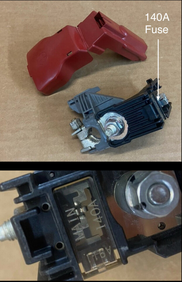

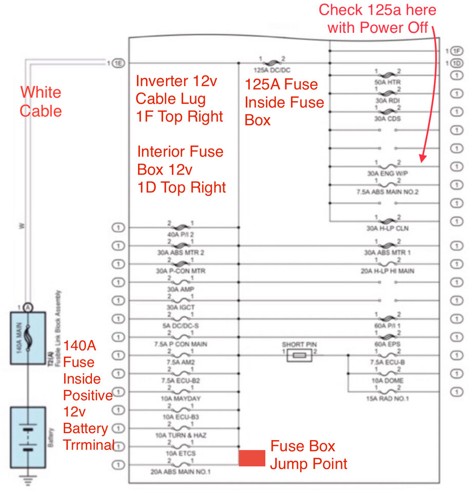

    `@ChapmanF Looking through 3rd gen fuse diagrams and also like RJ mentions here, there is a fusible link in the engine compartment (125amp it seems, not 120amp - and this applies to V and C so I suppose regular Prius) and another fusible link at the battery (140amp). What could possible damage that 140amp rear fuse - called MAIN by Toyota? Excessively drawing from the 220V access points at the rear?
    What's the purpose of that fuse? That 140amp is for 201V? Seems like so many amps at that current. There's no 12V back there, right? You'll see why I ask -
    When people fry the 125amp fuse (that I called 120amp), it's the one in the engine compartment, right? It's almost never the 140amp one at the rear?

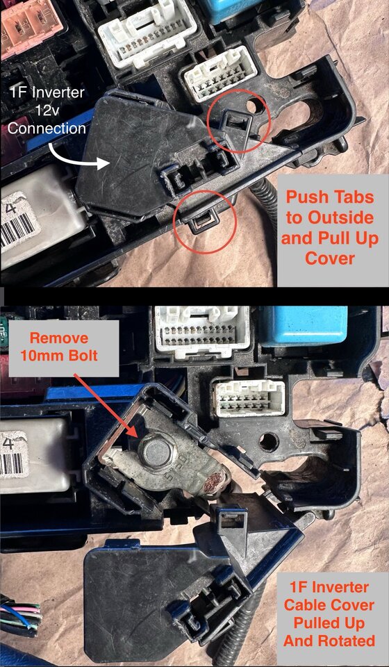

    A view of the 125amp fuse, posted by RJ in the 8th post here:
    That makes me think the 12v 120amp (or 125amp if I can find one) breaker idea is viable. Let me know if you think this is a bad idea in any way. Example of a 12v 125amp breaker.

  16. rjparker
    rjparker Tu Humilde Sirviente
    Jun 6, 2008
    10,981
    6,885
    Texas Hill Country
    If you dead short the Engine Fuse Box Jump Point to chassis with the engine off you will blow the 140a fuse.
    If you dead short the Engine Fuse Box Inverter 12v cable lug with the engine off you will blow the 125a fuse.
    Most of the other fuse box 12v bus lines are inside the fuse box and unlikely to be dead shorted. Unless you are removing the cables at the inverter and short it to chassis with the 12v battery connected like a recent post experienced.
    The sure way to blow the 125a fuse is a split second reverse polarity jump from another vehicle. That is a bad day since the 125a fuse is nearly inaccessible unless you remove the fuse box along with its harnesses removed from the engine compartment.
