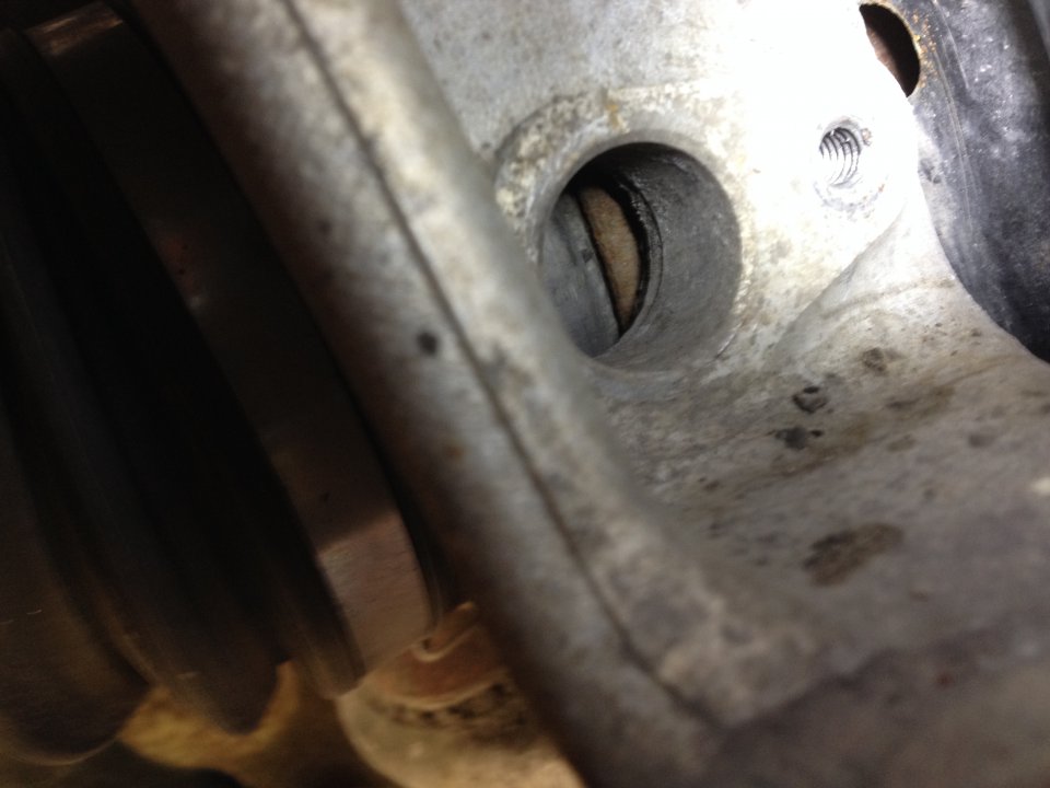

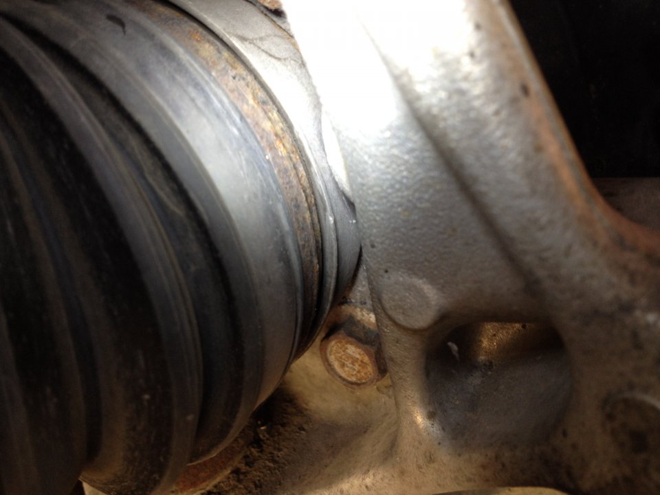

    im going to pull the sensor again and take a photo...Ive already cleaned it and unplugged/cleaned plugged the circuit back in and the wiring seems Ok..Cant follow it back to the harness but the lights were on when I got the car...Im going to take a pic of the toothed rotor also

    I dont see an exciter ring...:(

    I suggest you compare to the left front side to be sure, but it looks like the sensor is broken and the RF wheel was reassembled without the toothed ring.

    I believe the toothed ring is supposed to be part of the driveshaft, because it is not on the wheel hub.

    The other side has the shaft with the ring and today i ordered the half shaft for the right side front..i guess the dealer who installed the bearings did not replace the right front ring..Going to replace and clear codes and see the outcome.

    Received the shaft today. Started taking the existing shaft off and found part of the shaft was covering the toothed ring. Took the broken piece out put it back together. Test drove for about a mile and just upon coming to a complete stop had the little skid icon light flashed....Shortly after that all the lights came back on and got the same codes :(

    1. What exactly was broken?
    2. Did you compare the physical appearance of the sensor on the problem wheel vs. the sensor on the other side of the car?
    3. What is the condition of the toothed ring, did you fully rotate the ring 360 degrees to inspect every tooth for damage?

    I'm not sure exactly since the dealer maintaince records show both wheel bearings were changed but it was a ring shaped cover that was loosely spinning over the toothed ring. The sensor looks damaged. I did not compare it to the other side but it appears damaged compared to the new one that I recently received. The toothed ring was rotated and looks fine. The car is out getting new paint and I will install new sensor when I get the car back
