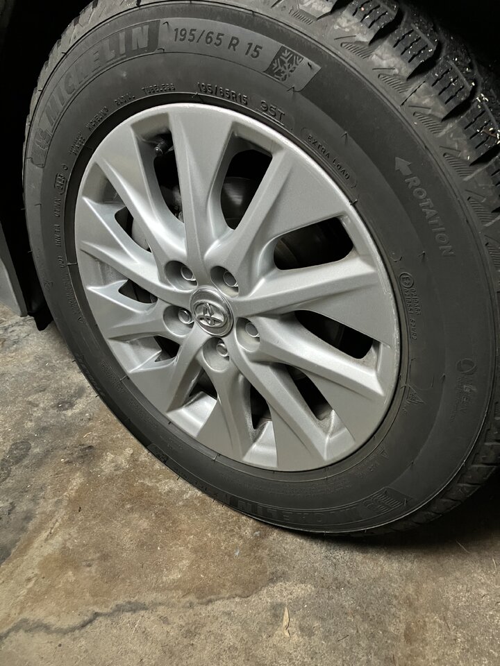

    The tpms sensors from eBay looked good, pic of one below. Tire shop only installed them, did not do any synching. I dropped the all season wheel set off at home, waited about a half hour, (read the manual, lol), initialized set 2 learning, and drove off. Took less than five minutes to synch.
    Such a shame to subject the nice wheels to this salt crap. Same thing can be said about the car, of course.

    Sensor:
    On the car:
    Same place of origin as OEM wheels:
    51 psi:
    Gokhan likes this.
