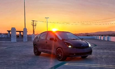

    Im about to put WildPeaks on my Gen 2. I have them on my Gen 3..
    only.. I'm putting Subi wheels on my Gen 2 in 17" and since I've got the subframe spacers installed, I plan on seeing just how much meat I can stuff in there.

    Best wishes on that! I enjoyed the Falkens, but they aren't available in the size I was looking for. For rougher terrain, I prefer more rubber and less wheel, in case I need to air down.
    As for the Subie wheels, some use the same bolt pattern, I know, but what about the axle size? For safety, I wouldn't want the lugs carrying the weight of the vehicle.
    In any event, I would think the front spring perches impose a hard limit on diameter. Do the subframe spacers increase this limit somehow?
    In any event, best wishes, and I look forward to seeing the results!
