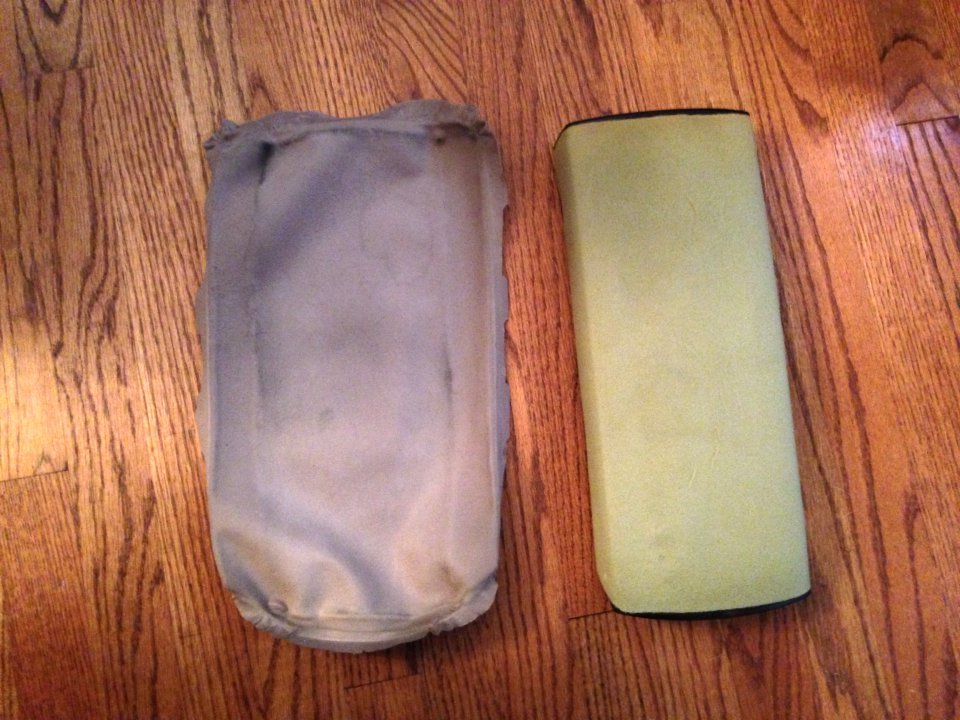

    Taking the console off was pretty easy, thanks to the tips on here. A lot of folks seem to cover right over the existing fabric, but I decided to remove it to avoid any lingering dirt and smell. Plus, it gave me a rough template to use for my new. Here is my filthy cover off:

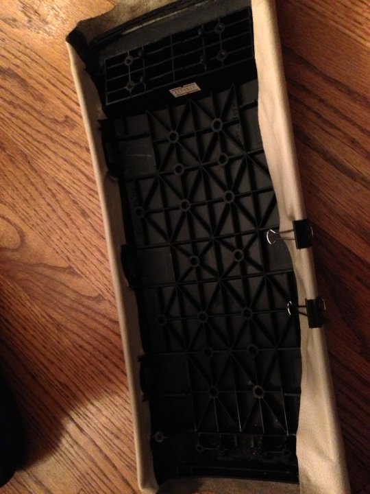

    I cut my leather to match the original fabric, then I stretched it out over the console cover, using clips to hold it on while I pulled it tighter. I let it sit like this overnight, to try to stretch out any wrinkles in the leather.
    Then came the arduous task of trimming edges and gluing down the ends. This just took a lot of patience. I would brush on some cement, let it dry a bit, and then stretch the leather out and lay it over the glue. That cement is unforgiving, you stick it down and that's it, no moving it around, so make sure you get it right the first time.

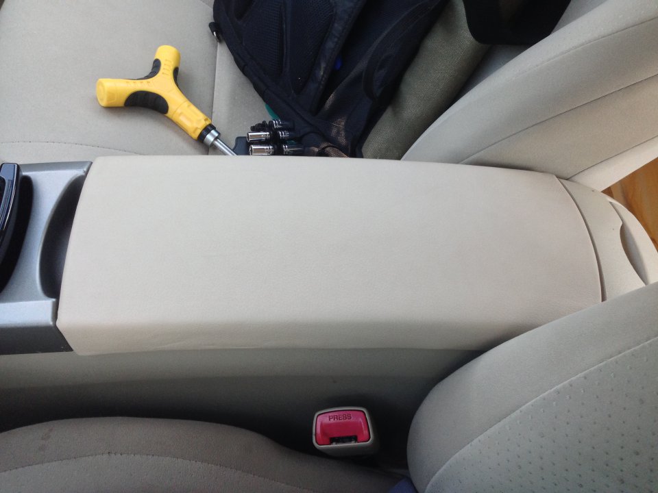

    Finally, here's my final outcome:
    Pretty happy with how it turned out.
    Overall, not a hard project at all.
