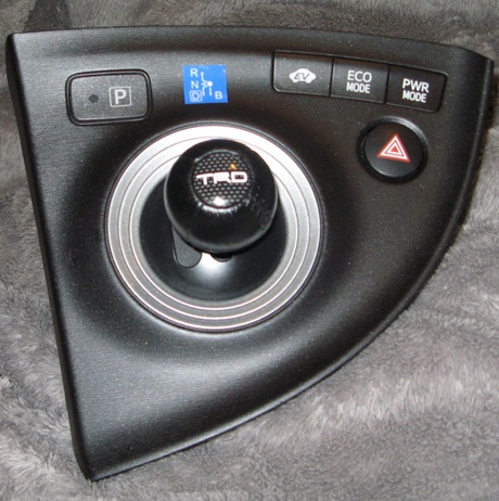

    Since the shift knob on the gen II has a similar mounting location, I cut down the lever on my 2012 Prius"v" and made this micro Duracon TRD knob that fist only an inch from the gate instead of two to three.
    Since the Duracon material used in TRD shift knobs are somewhat flexible, buy drilling it a few thousandth an inch undersize, its a very tight friction fit.
