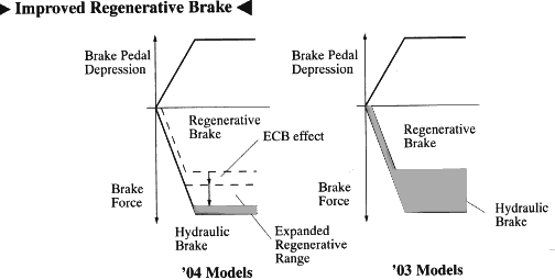

    It won't surprise you that the question's been taken up before on PriusChat.
    The answers are "more than you'd guess", "if you think you know the simple answers you don't", and "but less than in a car with no regen."
    You can see they are used at low speeds (where the MGs aren't generating enough power for useful regen), and at higher speeds (when too much regen power would be available for the battery to handle), and there are also various conditions that trigger the ECU into changing the proportions. The details change between Prius generations.
    It's already been suggested that you could datalog the line pressures, etc., using the OBD-II port, but that involves periodic messages being sent over the bus, so what you see has discrete updates and a bit of a lag. Brake business happens really fast. Old-timer member hobbit once built a little circuit that tapped the pressure sensors electrically and varied the brightness of LEDs on the dash, to have a more real-time display. I don't have time at the moment to search up that thread, but it's out there.
    The LEDs were saying "more than you'd guess", "if you think you know the simple answers you don't", and "but less than in a car with no regen."
