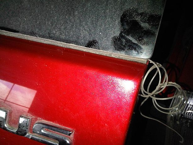

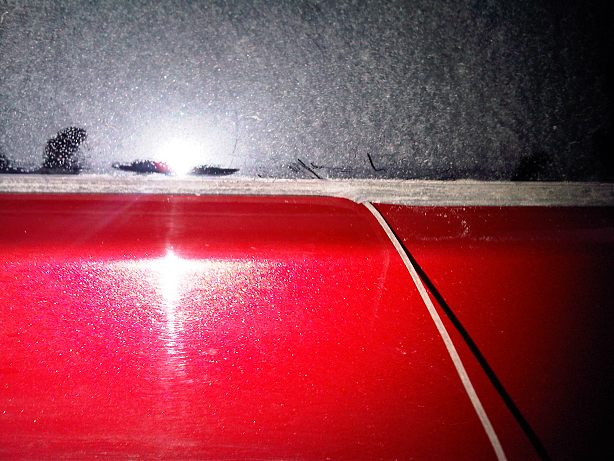

  20. PaJa
    PaJa Senior member
    Sep 3, 2009
    678
    116
    92
    Czech republic
    2017 Prius
    The similar technique, which I learnt when windshield was not glued to the car's frame, but inserted to rubber seal. The plastic tennis string in the action:
