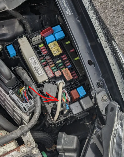

    According to @ChapmanF there's a disconnection you do at the under-hood fuse box, more convenient than actually disconnecting the negative cable at the battery: info < Note, this is in a Gen 3 discussion, but Gen 4 may be siimilar.
    For reference, Gen 3 fuse box:
    Having a hard time finding a Gen 4 fusebox image, perhaps OP can post one?

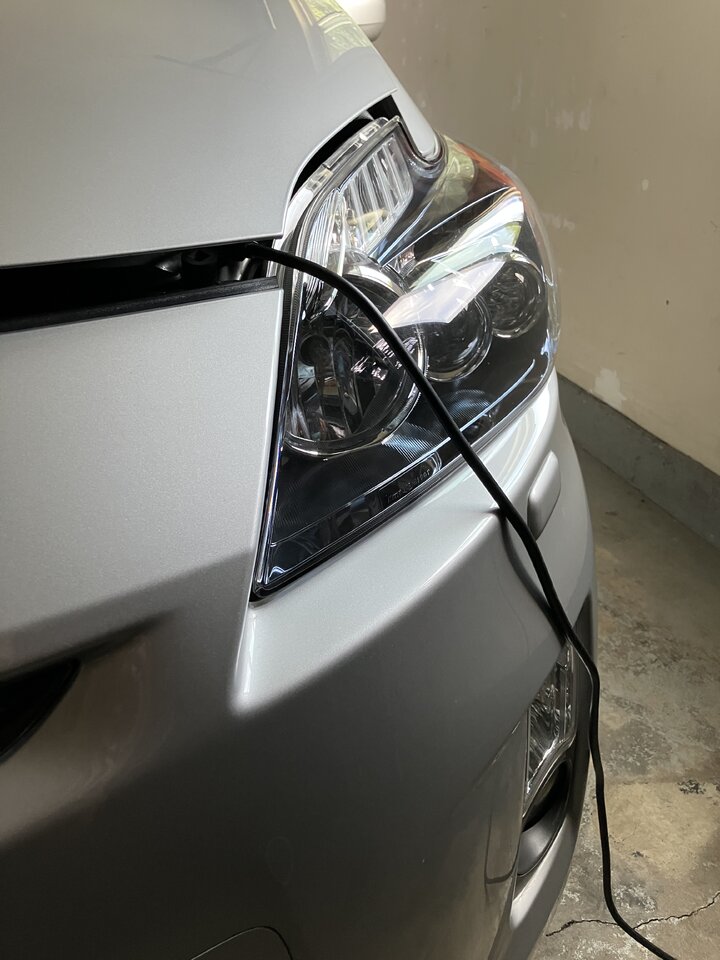

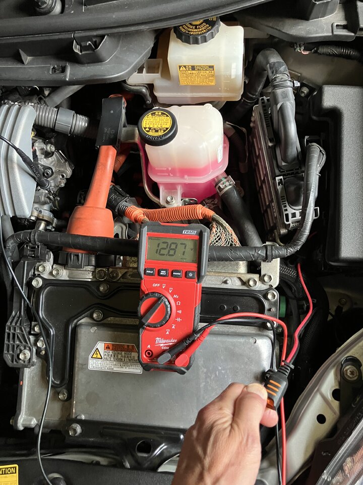

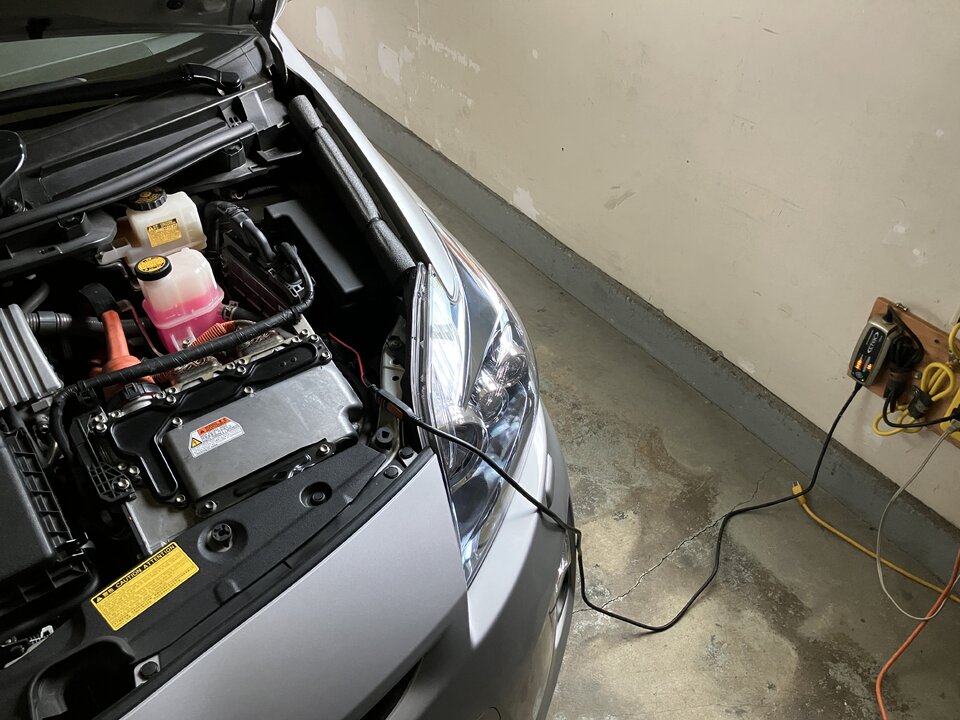

    We make a point of consolodating trips, say when we've got to drive somewhere, do the heavy shopping on same day, if practical. Then back on the charger the next day. Yesterday I had the dentist, then this morning doing my charger hook-up drill.

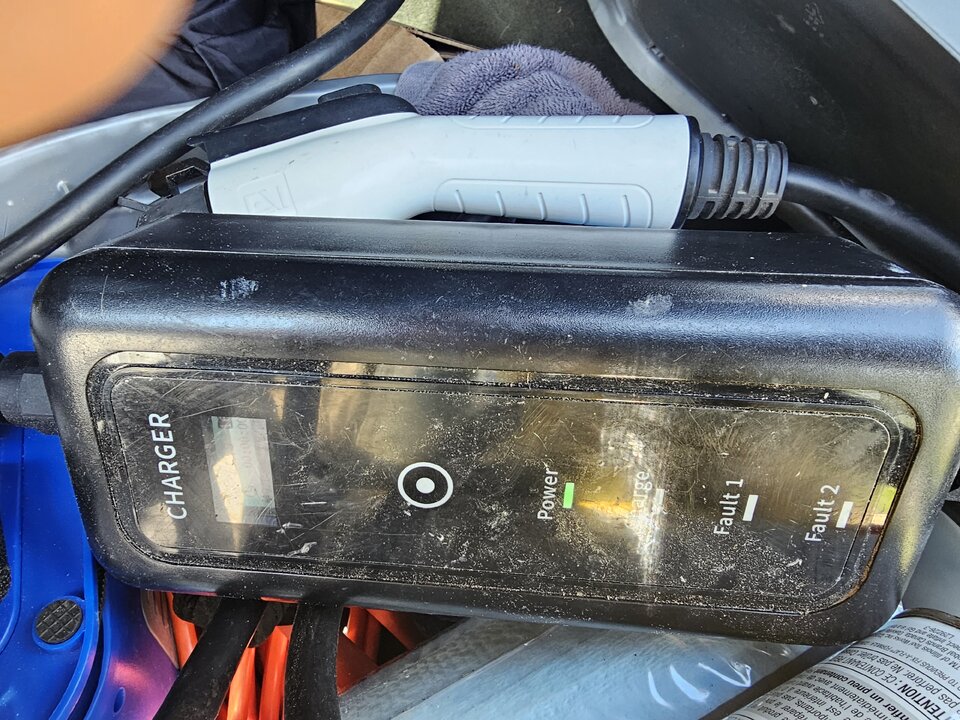

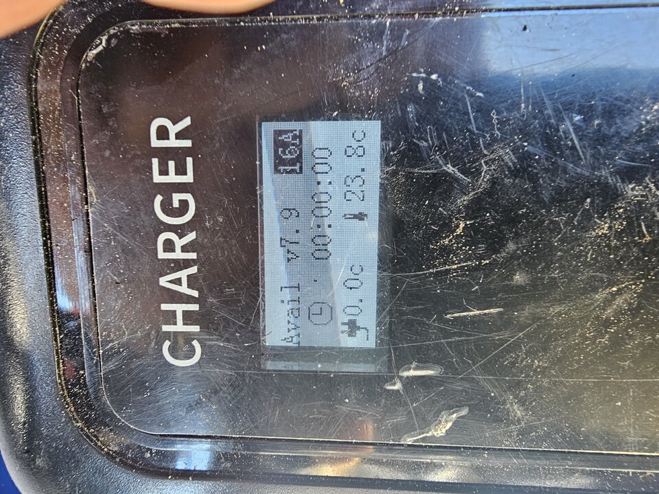

    I'd heard stories about the LVL 1 chargers that come with the car being stolen, so I bought a much cheaper one online. So far, it's been doing a perfect job.
    It's no longer listed on Amazon, but I paid $164. Less than 10% the price I was quoted from the dealer for an OEM cable.

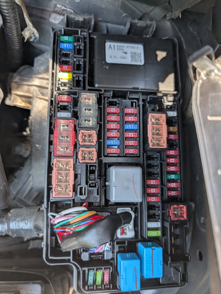

    @Mendel, I believe you asked for a pic of the Gen4 fusebox -- see attached.
