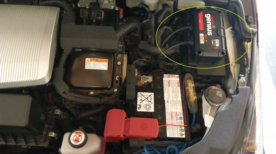

  20. Mendel Leisk
    61,561
    42,355
    @MSantos how are you securing that charger to the fuse box lid? Just gravity and the stiffness of the wires? Or maybe some sort of velcro and double-sided tape?
