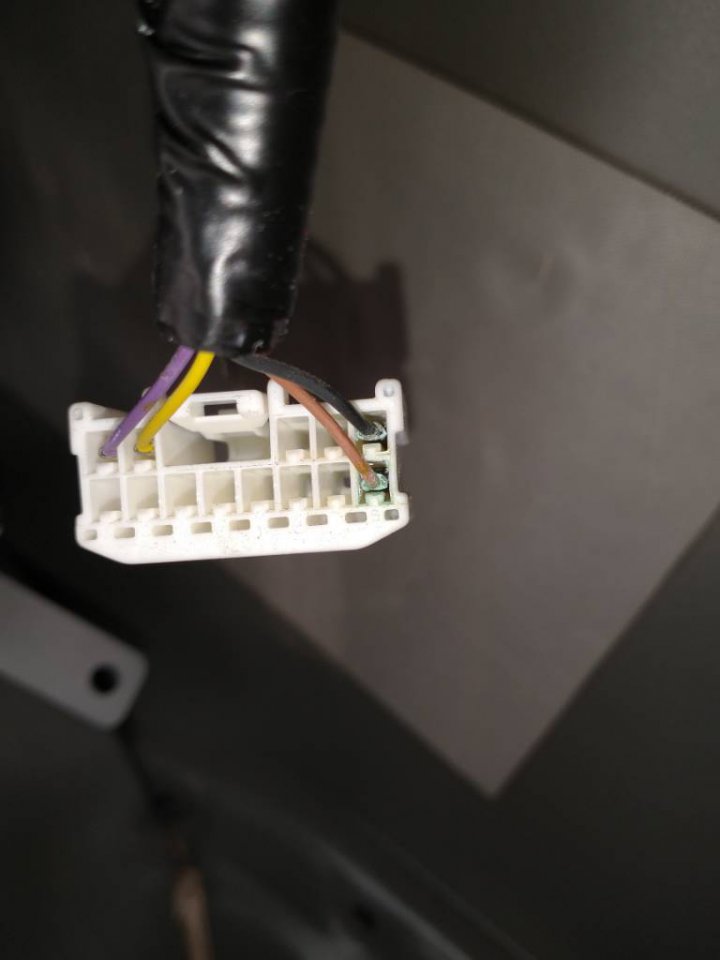

    Well, I pulled all of the connections and everything looks clean with no corrosion. Should I take the battery out and look at the busbar to make sure there isn't any corrosion on the bolts or can that also be done without pulling the battery?

    The pins on the left side of the orange socket look suspect, can you remove the ECU cover and inspect at the motherboard?
    You shouldn't need to take out the battery to remove the main cover for inspection, just remove the back seat. That new OEM battery came with new busbars, and a voltage sense harness, but the old ECU was swapped into the new pack, so check inside the ECU first.

    Re-looking at those pins and they do look a little discolored. I removed the cover to the ECU and it looks fine but I will post a photo.
    I will pull the cover and take a look at the harness. I believe that battery was installed about 4-5 years ago.

    The pins on the left look a little corrupted. Source for a new ECU?

    Check the backside of that socket, where the pins exit the socket, and where the pins enter the PC board. Though hard to tell, the lower right pin in the last picture kind of shows a dark spot on the PC board, if corroded you may just call it dead. Post closeup pics if you can.
    If it passes the above visual, try to clean up the pins inside the socket using a tiny strip of emory board, or a piece of curved sandpaper.
    You could buy new, but many would just buy used. There are some members here that you could support, or check CL / OU / fleabay

    No discoloring of the pins on the flip side so I will clean up the pins in the socket and spray it with Deoxit.
    A few of the nuts on the busbar have some corrosion so I will remove and clean those up. Also, I checked all of the cells and they all read 7.84 or 7.85.[​IMG] [​IMG] [​IMG]

    Do another OBD2 scan, is the only code (DTC) being reported P3030?
    Before buying a used ECU, here is the workup for DTC P3030 : https://share.qclt.com/%E4%B8%B0%E7%94%B0%E6%99%AE%E7%91%9E%E6%96%AF%E5%8E%9F%E5%8E%82%E8%8B%B1%E6%96%87%E6%89%8B%E5%86%8Cpdf%E6%A0%BC%E5%BC%8F/repair%20manual/04pruisr/05/20zmw/cip3030b.pdf
    You might test the No.2 wire frame first, likely one of the voltage sense wires is broken at a busbar. A replacement is around 60 usd.

    On page 05-933 starting with step 6. Requires removal, and testing with a multimeter. That wiring harness is delicate, even if it doesn't test bad, it could break during reassembly. Hard to believe it corroded to failure in 3 years. If bad, spend the 60 for the replacement.
    Curious if one of the voltage sense wires corroded/broke off near that staining?
