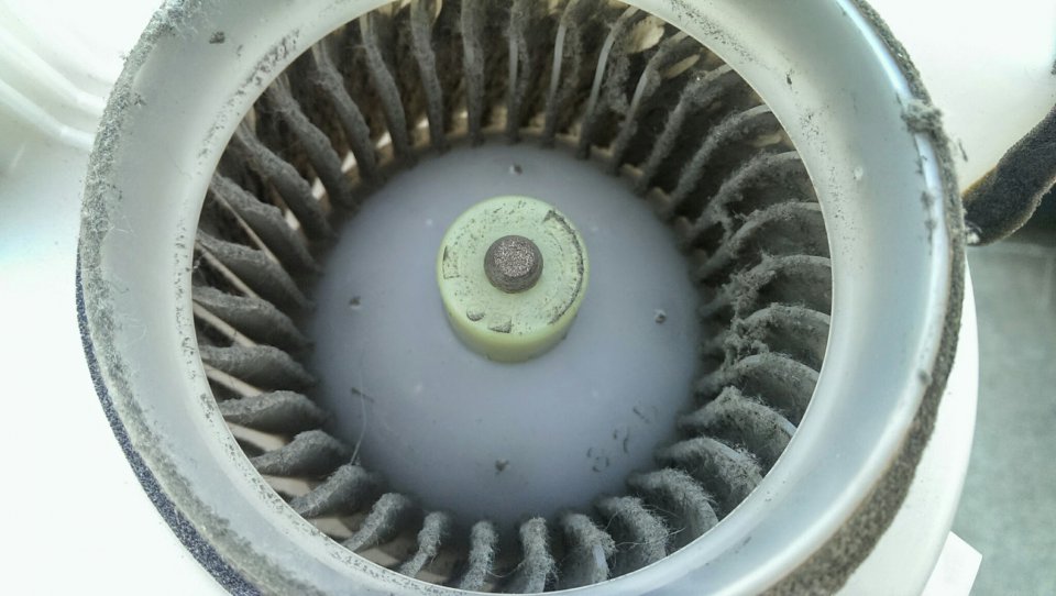

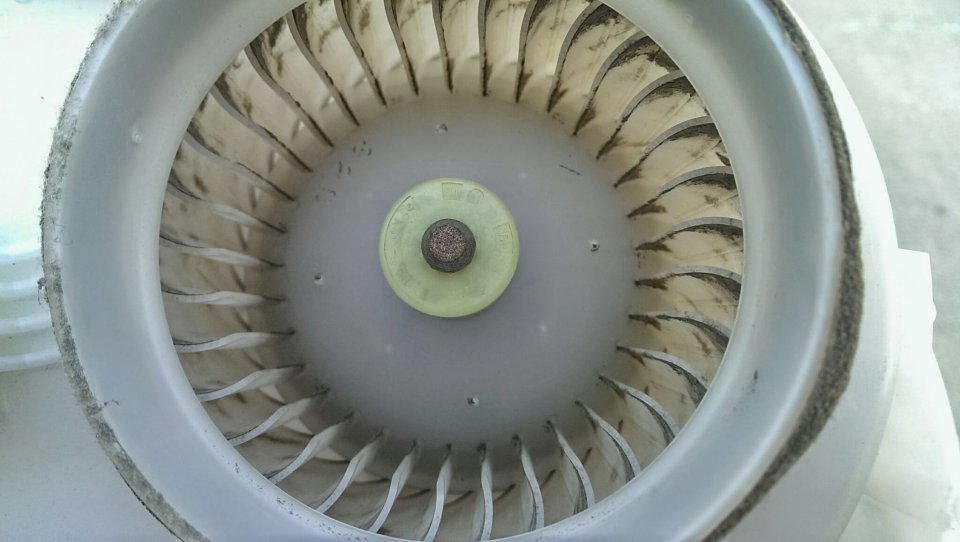

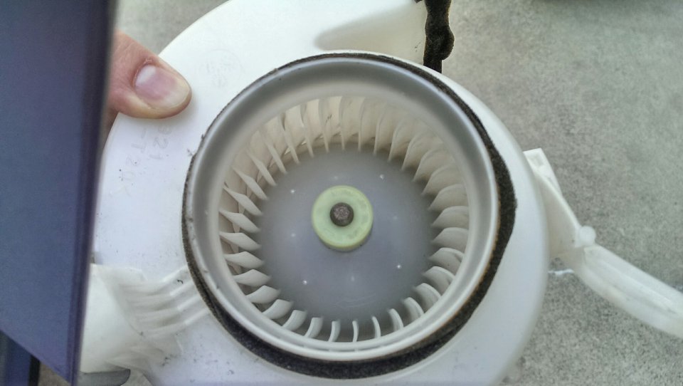

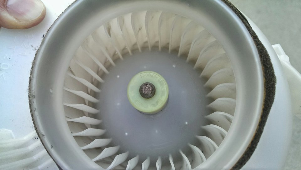

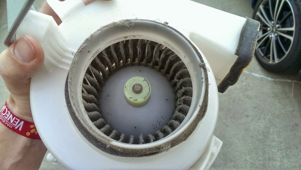

    Just cleaned out my blower fan on Sunday. My car has about 103k miles on it, and it wasn't as clogged as some photos I've seen but it was good to clean it out nonetheless. Pics attached. Took my buddy and I probably 1.5 hours in total.
    Dirty:
    Cleaned with compressed air:
    Cleaned again with contact cleaner:
    PriusGuy32 and Dino33ca like this.

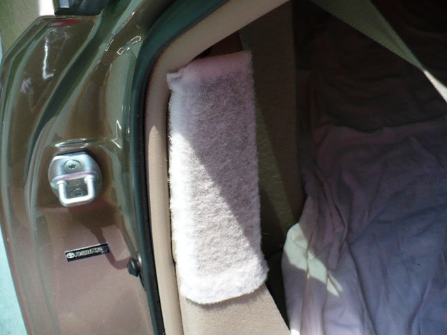

    I've cleaned the fan a couple of times now, and (currently have a piece of fine mesh screen (the type used for insect screens on residential windows) fastened on the inside of the inlet grill.

    There's a bolt, holding the slim segment of seat back with the grill. Push down on the back edge of seat cushion right there, and shine a light: you'll see it in behind. It's 12 mm socket size I believe. You'll need a ratchet wrench and 6" extension.
    Once you get it close to off, reach in and get your fingers on it, you don't want to drop it, end up fishing for it.
    Once that bolt is off, you just kinda yoink up and out on that whole segment to remove. There's a Velcro attachment at the bottom you leave connected, or you can peel it off, take it right off.
    It kinda helps to unlock and tilt the seat back forward a bit.
    Here's the screen installed. The aluminum screen material has a strong concave bow as shown, and the stock grill has a mild convex bow, at the back. So just a couple of black thread loops have been added, to pull the screen taut against back of grill. I think you can just spot them if you zoom the pic.

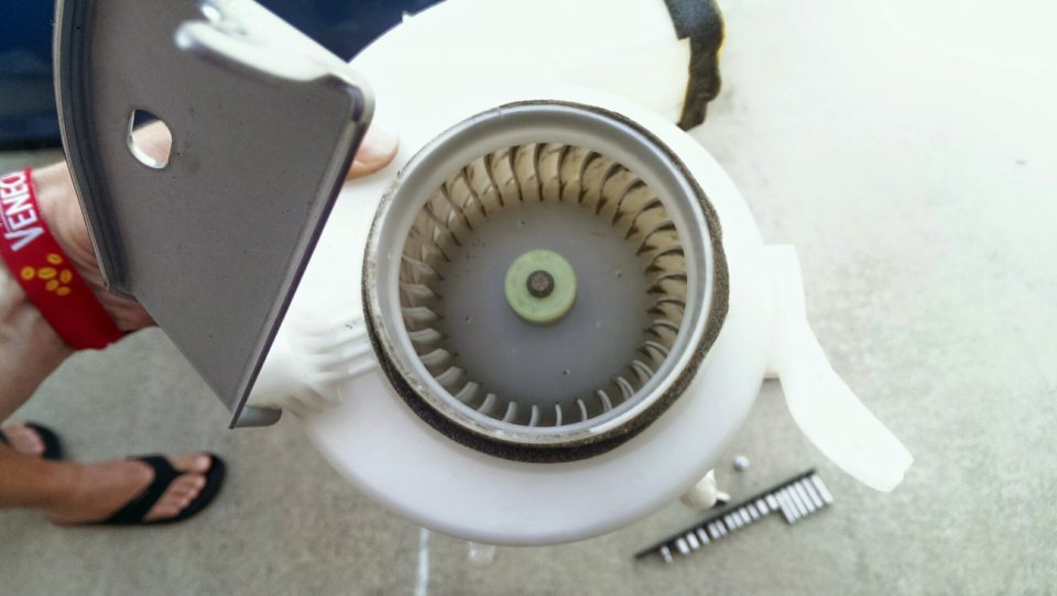

    A Q-Tip (dry or moistened) works good with the close spaced fins of the fan barrel. Then one of those boa dusters for the ductwork, as much as you can reach. Then blow everything out, with compressed air, a wet/dry vacuum, leaf blower or what have you.
