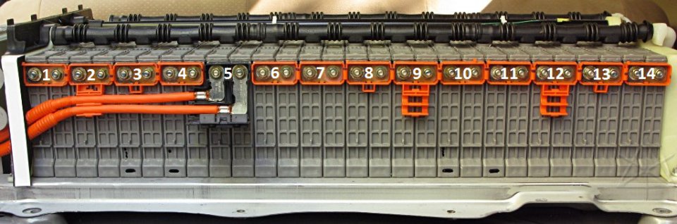

  7. MTL_hihy
    MTL_hihy Active Member
    Sep 2, 2013
    536
    261
    Maritimes, Canada
    Load testing should show you which modules are not performing up to par but block 14 should be the module pair on the far end of the pack furthest from the ECU (see pic).

  10. Mendel Leisk
    61,529
    42,343
    Seems strange, that something so crucial should be so poorly identified.
    Jo-Jo Joseph Mims and Rodger C. like this.
  11. dolj
    dolj Senior Member
    May 14, 2012
    8,645
    4,394
    Wellington, New Zealand
    The problem it is not consistent across generations of Prius–in some it is one way and in others it is the other way. As I have a Gen II, I just remember which way it is for a Gen II. I couldn't tell you what is is for other generations, I just know it is not all the same.
  12. Mendel Leisk
    61,529
    42,343
    Yeah couldn't they have some sort of strap that runs over top, with clear labels. It puts me in mind of a Honda valve clearance instruction, with a totally messed up diagram indicating which end was cylinder #1 vs #4.
  13. greasemonkey007
    greasemonkey007 Active Member
    Sep 20, 2013
    287
    106
    South Central Arkansas
    On the 1st gen, block 1 is next to the ecu (driver side). However, in the 2nd gen block 1 is away from the ecu (passenger side). Again, just measure voltage at rest and under a load and you'll see which ones are weak or faulty.

  19. Hybrid Battery Exchange
    Nov 15, 2017
    83
    93
    Gresham, OR
    Vent tubes were being removed sometime in 2011 and all gone by 2012.
    Battery blocks are counted from the module which you attach the negative lead, voltage grows with each block. Voltage at block 1 will be ~16 volts, voltage at block 14 will be ~224 volts.
    Gen 2 and gen 3 are the opposite. Gen 2 uses a long negative lead and a short positive lead, gen 3 uses a short negative lead and a long positive lead.
    If you're working on a Camry or Lexus battery and are confused which block is which just follow the negative lead to block 1.
