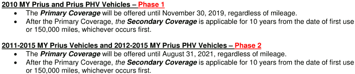

    Excel
    Brake booster campaign is free up to August 2021 unlimited miles. Check NTHSA website, and you can call Toyota North America to get some price cut. Not sure why you did not get this brake booster done before that campaign is over. https://static.nhtsa.gov/odi/tsbs/2019/MC-10164922-9999.pdf
    It is similar to campaign in Prius V but I lost the link for Prius 2011-2015. I believe it will be limited miles after 31 August 2021. https://www.google.com/url?sa=t&source=web&rct=j&url=https://static.nhtsa.gov/odi/tsbs/2020/MC-10181800-9999.pdf&ved=2ahUKEwimyYPpytX2AhWJSPEDHX8FCoIQFnoECCEQAQ&usg=AOvVaw0jb3Kt3K75MEocNFQ93-Jo

    Ok
    Prius V is now also covered 10 years 150k miles now. It was unlimited miles.

    • Sadly, this issue surfaced right after a relevant Toyota recall repair ended and I was unaware of this until it was examined. I did call Toyota and confirm that no mail had been sent to my address or messages send my way elsewhere to inform me of this issue. I will be submitting a request for reimbursement, but I'm not sure if this will be accepted.
    • Beyond that, the independent shop that isn't being too transparent on what is or isn't messed up and keeps referring to a vague TSB recommendation to repair a brake booster/master, pump, and reservoir along with a brake fluid change, but I can't seem to track down any TSBs that mention that a reservoir fix is needed in this situation. I've listed two TSBs that I've found so far.
      • MC-10181800-9999.pdf
      • MC-10198141-9999.pdf
