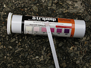

    It's really quite easy to stick a Brake Rock on the pedal, reach an arm behind a rear wheel, and crack a bleed screw enough to get a small sample of fluid, which you expect to be the darkest and disgustingest in the system.
    Mine at 145,000 miles:
    110,000 miles in hobbit's Gen 2:

    @ChapmanF: Just confirm, your measurement shows 10 ppm for both cars at over 11 yrs, 110k/145k miles, respectively, on the original brake fluid. There is no need to replace the brake fluid, correct?
    The reason I ask is because I have a Prius and a Prius C, both are 2012 model year and both have about 110k miles. On one hand I want to get them maintained properly, on the other hand I don't want to do something necessarily. For me there is always a chance to get something messed up, either by me or by the so-called "professionals".
    IIRC, in a thorough study reported on PC someone concluded similarly to your results: his Prius brake fluid was still in very good condition after 100k+ miles driving. I just cannot find the link.
  18. ChapmanF
    28,717
    19,016
    It may have been hobbit; at least, he did so study and so conclude, and the image of his test strip that was in my post came from his page, but it looks like I didn't give his link. Here it is (scroll down past the tires).
    I wouldn't be surprised if you found another report on PC saying the same thing; hobbit certainly didn't apply for a monopoly on brake fluid testing. But his report is the one I know about.
    Of course, driving and environmental conditions can be different, and if you're really looking for some peace of mind without having work done just to do it, you can get those strips for not a lot of money and dip your own.

    Yes, you are right. It is hobbit, and the lower picture did come from his report.
    What about the top picture of the 145k test? That's from you, right? how do I read the result? Also 10 PPM?
  20. ChapmanF
    28,717
    19,016
    That was mine, and yes, it looks ten-ish to me.
    You can see that when hobbit did his, the test strips were brake-only, and the smallest package available was that cylinder of them (100? I don't know), probably more than a non-commercial user would be able to justify.
    By the time I checked mine, the supplier was offering combo strips (brake fluid on one end, coolant on the other) and in smaller packages of 15 individually sealed, reasonable enough for me to pick one package up, keep some, give some to some friends....
