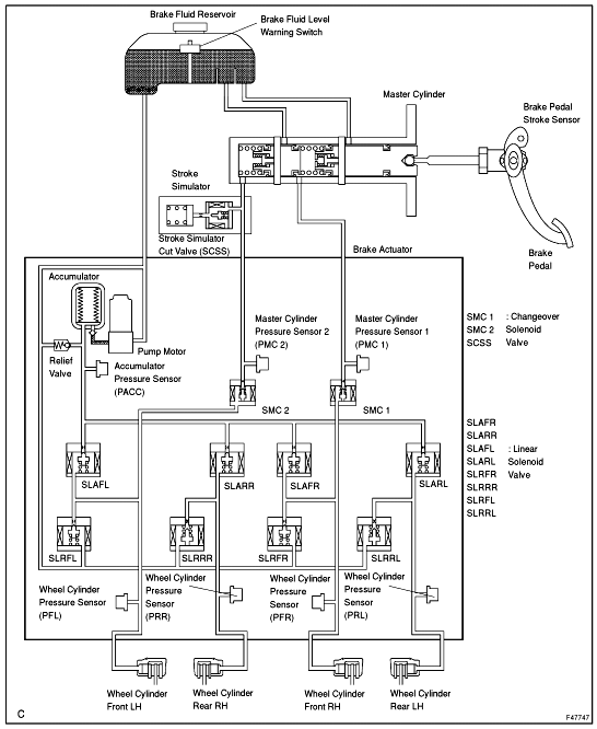

  12. JimboPalmer
    Apr 14, 2009
    12,470
    6,878
    Greenwood MS USA
    Somewhat the reverse.
    There is an all hydraulic path from the master cylinder to the slave cylinders in the brakes, which is short circuited when regenerative braking can do the job. With Engine braking adding it's own complexity to the mix. This schematic is one I show to explain why 'bleeding the brakes' is not as simple as other cars, but if you look at it you see that there is always a hydraulic path, but it may lead back to the master cylinder if conditions permit.
    When you press the pedal, brake fluid moves. Depending on how well regen is working, it makes it all the way to the friction brakes. So it is not brake by wire, if you press hard enough you always get friction brakes. (the diagram is of Gen 2, but I believe it still represents how the brakes work)

  14. fuzzy1
    17,817
    10,612
    One way I would try to describe it is as a brake-by-wire system layered on top of a traditional hydraulic brake system.
    The regular touch and feel of the system, including control of the power assist, is brake-by-wire. A 'stroke simulator' takes the first portion of the brake pedal travel, transmitting your foot force to the brake control system and that system's feedback force to your foot. This portion is equivalent to the vacuum-boosted power assist portion of previous cars.
    Should the above system fail, the stroke sensor should bottom out, and then you are putting your foot pressure directly on the brake master cylinder, thus directly into the hydraulic system. You now have old fashioned manual brakes, without power assist. This is also equivalent to how previous power assist brake systems behave when their assist fails.
    Federal regulations require both types must meet essentially identical performance requirements when they suffer system failures and go into back-up fail-safe mode. With the vehicle traveling at a set highway speed, it must stop within a specified (but fairly long) distance when a certain force (500N, metric for about 112 pounds-force) is applied to the pedal. Just like the old days before power brakes, this means essentially putting all your body weight into the pedal.
