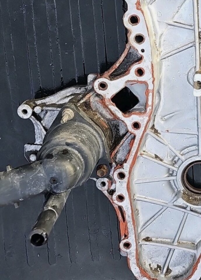

    Yeah, I'd say the epoxy is useless. Calling a mobile welder.

    A mechanic has a big mental tool bag of skills. You need to use AI to get a list of the possible methods. Problem is you haven't the muscle memory of any of these skills and you don't have the tools.
    Solutions:
    1. Electromagnetic induction heater: Magnetic Induction Heater Bolt Removal https://a.co/d/0ZqvJ1Y
    2. Weld a nut onto it and use that plus heat
    3. Use grinding wheel to grind bolt flat and used hi carbon steel bits purchase anywhere except harbor freight after using a center punch to drill into that bolt with left-handed drill bits and then an easy out
    4. Cut a piece of aluminum off and TIG weld in other piece of aluminum on drill it and start over

    Bought a 3 in 1 welder from Amazon. Should have it tomorrow. I took the wiring harness in that area off. I have enough room to weld a nut on that bolt from the side. I'll also get the bolt cherry red hot, which ought to help. Tomorrow is the big day. My Prius seems to have a lot of brittle bolts. I'm getting the tools in place to deal with them.

  6. Hayslayer
    Hayslayer Active Member
    Nov 6, 2024
    539
    331
    I don't want to be a debbie downer, but I have a bad feeling you're about to wreck this thing. There comes a time when you fold your cards and seek experienced help. F this up and there's no easy or inexpensive next try. I have yet to break a bolt on a Gen 2. Although I have no idea what you may have spent for an amazon welder, it's likely more than it would have cost to have a pro get it out. I wish you the best of luck.

    Well reputable mobile meccie . I'd rather play around on my own dime an expert isnt going to make lotsa difference . He wouldn'tve broken the mess. Toyoda bolts aren't brittle . Good rule on old stuff . Tighten one click first. Then reverse out by hand . Don't always reach for automatic tooling.

    With all due respect, you're making WAY too muich drama out of this. Don't you think I'd have a welding helmet and practiced several simulations before I tried it? It's not rocket science, just something I was unequipped to address. As a long term RN, the #1 way people get seriously injured working on cars is having the car fall on them. Not an issue here. This is a tiny weld, granted in a tight space, but very doable. Question is after I weld it, is it going to come out or will the rest of the bolt sticking out twist off? If that happens, I'm going to have to drill it out. Not my first choice, but doable.

    I spent $119 on the welder. $40 on a helmet. This is a tiny welding job. Taking off the water pump and the thermostat, I've had a total of 3 bolts break. I'm not doing anything except wrenching them off by hand. My car was up north for about 7 years. No visible rust on the body, but some rusting underneath. All of the bolts on the skid plate are rusted and snap if you try to take them off. All the bolts that broke are 6mm, I think (about 1/4 inch). The bigger ones have been fine. I got a welder who wants $250 to come out, no guarantee of success, other than he'll weld a nut on the bolt. I figure I'd rather have the tool for the next time I need it. Buying a 4 post car lift in another couple of months, just put up a 30 x 80 garage. Yes, I could pay to tow the car but not my way of doing things.

    The problem with beginner welding is you could permanently fuse the bolt into the timing chain cover or melt the aluminum. You have already stated access is difficult.
    The advantage an experienced auto shop has is they have plans a-z to get it out, have the best tools, muscle memory based on years of experience and a high likelyhood an easier method like acetylene heating and specific tools will get it out in ten minutes.

    When you throw in the towel and are at a point where a shop can't get it out, you can change the timing chain cover (removal needed for a head gasket job) or get a replacement engine, especially if yours is burning oil.
    A JDM engine replacement would be my choice for value (almost equal to a shop's head gasket job) with no extra cost added for a timing chain cover (maybe $200 on ebay).
    Your engine's thermostat mount
    A good cover and thermostat housing
    My takeaway is don't replace the thermostat unless it has failed based on measurements. Absolutely as last resort if other bolts are rusted.
