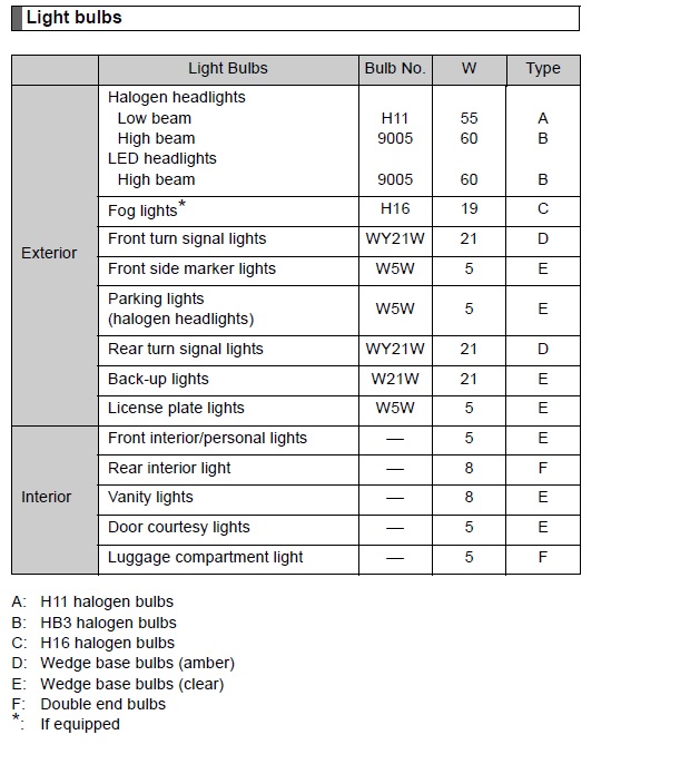

    Guys, stop posting bulbs. I want to know the type of bulbs used in my Prius. In my Dome I can't use any of the two bulbs posted here. Mine uses a different type. That's why I want to know where and what type is used, so I can by the corresponding LED.

    It's on pg 620 of my Owners Manual- probably different page for the regular Prius...
    Almost any of these will work for the dome light...
    Amazon.com: wedge led

    Thanks ny_rob, I saw that list but bulb number didn't looked right to me. Now the type are right and your link it's exactly what will work in my dome.
