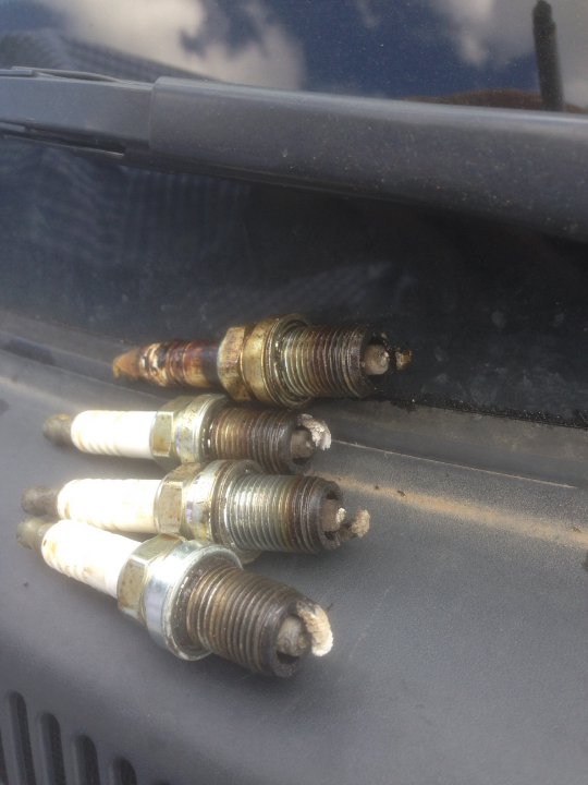

    Conclusion: MMO cylinder soak did not affect oil burning. The piston rings probably have perm damage.
    My mechanics poured 32 oz of MMO into four pistons, soaked for 4 hours, clean up and start engine.
    The SMOKE!!!
    It's like the car is burning. It lasted quite a while, 15 min I guess. Not sure if I can pass the inspection next year, possible catalytic converter damage? I went a little late, only see last 5 min smoking.
    With oil burning at 1qt per 750 mi. rate for past 30K miles, the spark plug looks terrible. I'm not sure how long the new plug will last.
    The car runs good for a week, then check engine light on. With too many codes there, he cleared the code, hope it will come on again, but 2 weeks past, nothing. Very strange.
    The MMO definitely cleaned the engine quite a bit. At least the oil cap is cleaner.
    See the old plugs picture

    Yep, the piston soaks or oil ring cleaning in general are only effective at early stages of oil consumption at lets say 1qt/3000 miles. If you keep driving with stuck oil rings, they simply wear out .
    BTW, 32 oz MMO for piston soaks is way too much. I use 1 oz per cylinder at one time.
    Now, while the plugs show the expected ash from oil burning, whats wrong with the upper plug? Valve cover gasket leak?

    Good question! And what will be the effect if they leak?
    Bad news again, the check engine light is on again, it shows the catalytic converter has problem. I guess my mechanic did not suck out 32 oz of MMO before he starts engine. That's why sooooo much smoke, lasted for sooooo long.
    Now what should I do? Checked some places, the new one cost $100, but one of the seller ask $50 only on ebay. Will that be ok? Somehow I can't post that ebay link here.
    I heard by law you cannot install used one, wondering why. If I keep driving, will it getting better? What will be the worst case other than emit a little bit CO gas?
    Anyway, if oil burning getting too bad, I'm ready to replace the engine. A used one only cost $5-600, plus $500 installation. Not too bad.
