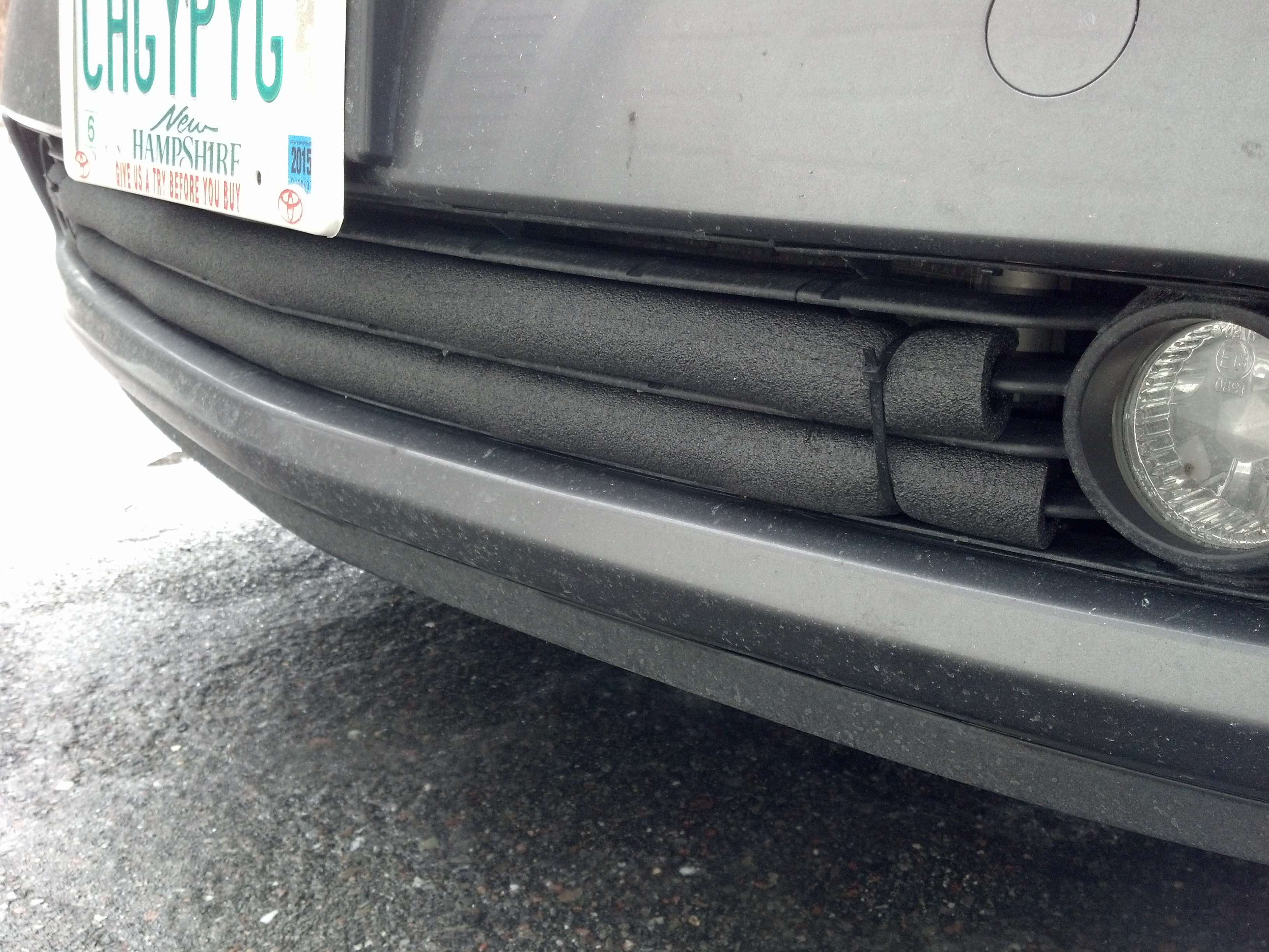

    Here's what I did:
    …and will shortly do again! (<$5 from HomeBoy-Despot) plus a couple of Zip-Ties!

    EBH (electric block heater) is an easy way in up mpg's too. Set it on a timer if you typically commute the same time each day, and your 5 to 7 minute warm up mpg hit is significantly reduced. IIRC, they're available on the priuschat store.
    You may find it just as effective to not even bother with the zip ties. The foam fits so snug (in most cases) that it just stays in place any way. It come off easier too, if your drive home as warmed up into the 80 degree range.

    The first year I tried it, the end of one of the sections kept working its way loose, so last year I used zip-ties, as I will this year! I think it might be the way I fit the pieces, if you look closely you will notice my foam straddles the grille-bars, whereas in the pics in the .pdf file, the foam is snug in between the slats! Perhaps I'll try that method this year! Thanks for the note! ;)

    If you go around the bars you'll want to tie them off. I use twist ties. They may stay in place but if one works itself loose it can catch the wind and fly off. The Gen2 is sized correctly for the foam. You can get a very neat & clean installation right out of the package. Good job, Wil.
    The top is compression fit. There's a better chance of you pushing one through than of it falling off.

    At my local HomeBoyDespot there are 2 sizes (½" & ¾"). I used the ½" but think the ¾" might do just as well (and see previous comments re. Zip-Ties or no Zip-Ties), and it comes in (3 per packet) lengths which are perfect for the width of the grille without cutting (I used 2, but you might want to use 3 (check the pics) - hope this helps - Good Luck!
