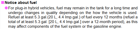

  13. Krypto
    Krypto Junior Member
    Dec 30, 2017
    Rhode Island
    Ha ha, my colleagues would yell at me for not reading the &*%$ manual! Thanks!!
