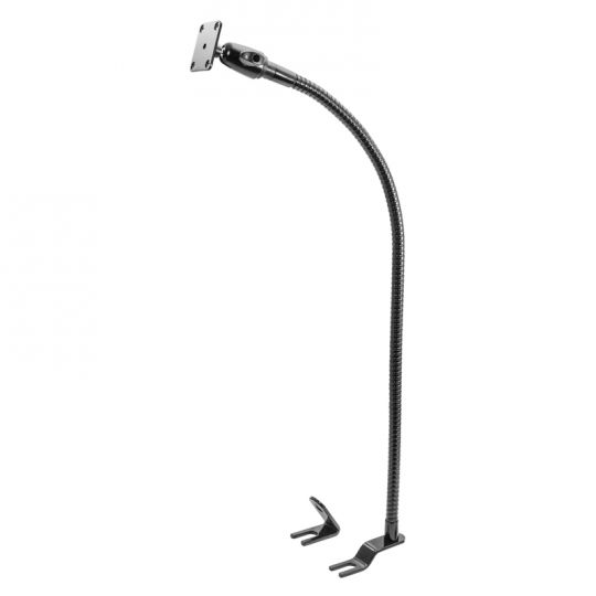

    When you had the console out, did you happen to see if there was a bolt this could be attached to:
    Arkon Mounts GN092-L28-AMPS Car or Truck Seat Rail Mount
    a bolt possibly near the end closest to that gap between the console and the front stack with the infotainment screen?

    There are some bolts on the car below the plastic cover. See Photo red arrow. But I don't know how appropriate they are for your purpose.
    There are a few screws underside of the plastic cover holding the bottom of the cup holders and heated seat switches. See photo below, red arrows. But either way, in order to use any of them for the attachment of your parts, you would have to cut the plastic cover to allow it to come out out of the cover.
