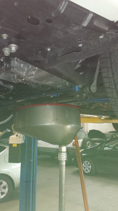

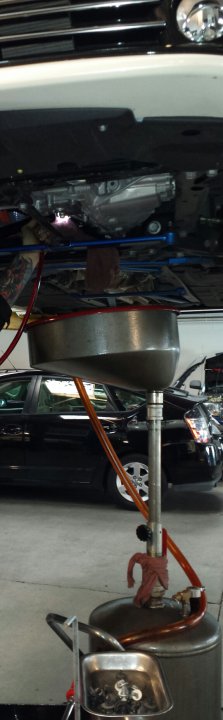

    I see pics like these and wonder how cool it would be to have a lift and a drain cart in my own garage. Maybe in my next lifetime.
