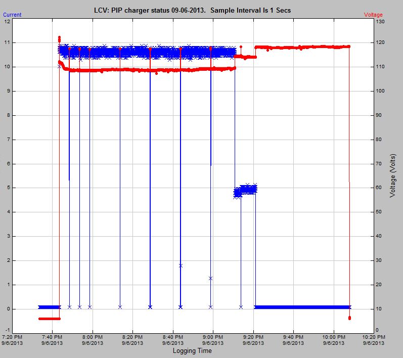

    Yup, me, I had charts from my data logger showing that the charger drops to zero amps eight times during my two hour and 34 minute charge.:cool:

    In order to check the SOC, the charging has to be stopped. Interesting that the charging current drops near the end.

    I had a thread called "Attention Kill A Watt Nerds" with the charts, but alias, the charts are no longer there.:cry: :notworthy: :sick:

    That is how the charging cycle is supposed to work for lithium-ion batteries. Cell phone chargers behave the same way.
