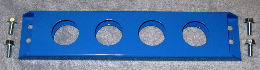

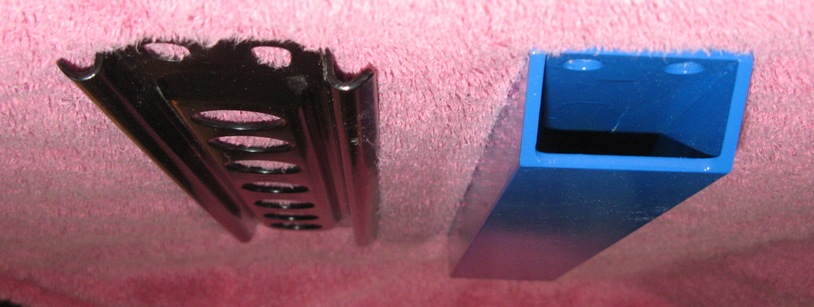

    It's keeping the separation distance between the rails constant. The rails act like the free ends of an inverted "U."
    The G7 still flexes but much less than the OEM brace.
    There is virtually NO flexing or change in the separation distance in the "box beam."

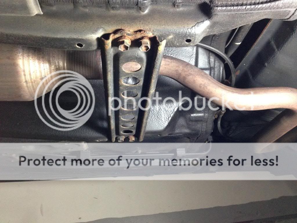

    I just replaced my rusty old chassis brace with the G7 brace and love the quality and I dig the black finish vs the green finish of the more expensive alternative. Not sure if I'll notice any difference on the road, but the rusty one had to go!

    My brace arrived on Saturday and I installed it Sunday morning in about 30 min. I have pretty long arms so I didnt need to jack up the car to install it. I used a 12 pack can of sodas to hold the brace in place while I lined up the holes and started threading in the bolts. Took 20 min tops.
    It seems to feel better while I am driving, but that can be just my imagination. I know it looks a heck of a lot better than the flimsy stock piece so that is good enough for me.

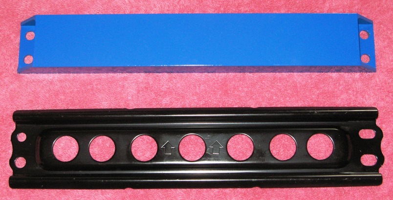

    Just for the record: I installed Mike's box beam on my 2006 P2 and noticed no difference at all.
    BTW I am a relatively fast driver with track experience so should have felt something I guess.
    100% placebo, no doubt.

    If you has other modifications done, it may have very little effect.
    If yours is stock it will definitely have some effect.
  12. Fam-ploeg
    Fam-ploeg Junior Member
    Oct 5, 2011
    Netherlands
    My car is 100% stock. Don't notice any effect.
    The only explanation I could come up with is that a brace may work on a pre-face lift Prius 2, but Toyota improved body stiffness sufficiently from 2006.
