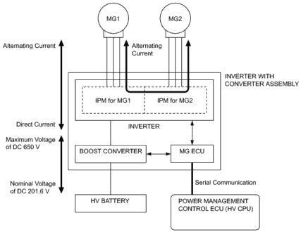

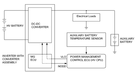

    The terminology can be confusing here. When you check the 12-volt charging voltage, you are checking the operation of the DC/DC converter. If you buy the entire shiny "INVERTER WITH CONVERTER ASSEMBLY", that DC/DC converter is included; it's the thing bolted to the bottom. But it isn't anything to do with the codes you have.
    When people say "the inverter", they can mean a couple of things: either the whole shiny box (which includes the DC/DC 12V converter), or just the actual power electronics for the motor-generators (the rest of the stuff in the shiny box, but not the DC/DC 12V converter).
    The "rest of the stuff in the shiny box" is what you see here within that central box "INVERTER WITH CONVERTER ASSEMBLY": a boost converter, an inverter circuit for each MG, and an "MG ECU" controlling it all.
    Notice that diagram doesn't even show the DC/DC 12V converter, even though it's also part of the "INVERTER WITH CONVERTER ASSEMBLY". There's a separate diagram that shows only that part, and not the other stuff:
    The MG ECU makes a cameo appearance in that drawing too, just because the NODD and VLO circuits for controlling the DC/DC converter happen to physically pass through it, but other than that it's not involved.
    For each motor generator, six transistors are needed so that the DC supply can be sent in either direction through each of the MG's three phase windings, arranged like this:
    These are big insulated-gate bipolar transistors (IGBTs). There are two MGs, so there are a total of twelve IGBTs controlling them, six for each MG.

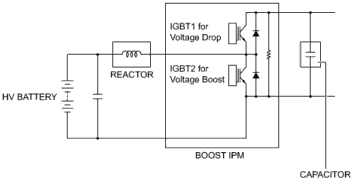

    Also, there's that thing called the boost converter, which uses two more IGBTs. Its job is to take the roughly 200-volt battery voltage up to more like 650 volts for the MG inverters. In fact, it's bidirectional: it can also convert the higher MG voltage back down to the battery voltage while regenerating and charging the battery.
    So inside the inverter assembly, ignoring the 12V DC/DC converter which is a different thing, there are a total of 14 IGBTs (six for each MG and two for the boost converter), and associated electronics for switching them, monitoring their temperature, and so on. All 14 of those are built into one big Integrated Power Module (IPM), which for gen 3 looks like this:

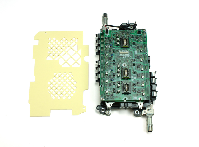

    The three big rectangular features down the centerline are the groups of IGBTs (or leading to them, on the side you can't see against the heatsink). They're too small in the picture to count the transistors in each, but you can see two of them have tripled-up components to their left: those are the two groups of six, serving the two MGs. The one remaining has doubled-up components to its left, and is the group of two IGBTs making up the boost converter.
    That whole thing is the IPM. You can see it even has hose nipples sticking out where the coolant hoses connect: the water-cooling heatsink is part of the IPM. (The 12V DC/DC converter ends up bolting to the bottom of that heatsink, so it gets cooled too. The yellow stencil in the picture is what you use to apply the right amount of heatsink compound before bolting them together.)
    The big reactor and capacitor shown as parts of the boost converter are not on that IPM assembly; they are separate big parts also inside the inverter case.
    Some people read "IPM" as "intelligent power module" instead of just "integrated", but it doesn't have a whole lot of 'intelligence' to it, other than doing some monitoring of the temperature and operation of its big IGBTs. Most of the inverter's 'intelligence' is in the MG ECU, which sits on a bracket up above the IPM, and looks like this:

    So that's the lay of the land. Now, when something on the IPM fails, depending on how heavy the power flow is at the time, it can be a pretty big boom. Sometimes they only will have to replace the IPM. Sometimes it will have damaged the MG ECU mounted above it, or the current sensor mounted near it, and one or both of those will also have to be replaced. Sometimes it even damages the metal case, in which case you get a whole new shiny assembly. It's all covered under the warranty extension in any case. Their instructions tell them how to evaluate which parts were damaged and replace whatever's needed.
    Your code P0A7A is easy to understand from its fortune cookie, "generator inverter performance". There's been a failure in the part of the IPM that runs MG1.
    Your P324E code has a fortune cookie mentioning the MG ECU. That may have taken some damage, then.
    The P0A94 is the code that often misleads people, because that code's fortune cookie (standardized by SAE because it's a P0 code) is "DC/DC converter performance". And nearly always, in a Prius, when we talk about "DC/DC converter", we mean the one producing 12 volts and charging the aux battery.
    And nearly always, we say "boost converter" when we mean that voltage-boosting section of the IPM. (If you think about it, that is another DC/DC converter too, just one that converts 200 VDC to 650 VDC and back again.)
    The "DC/DC converter" that the P0A94 code is talking about is the high-voltage boost converter, not the low-voltage 12V converter. So it's that other group of IGBTs on the IPM. And you don't learn anything about it by testing the aux battery voltage, because that's just testing a different thing.
    I have been guilty of spreading the confusion myself in some of my older posts. Before I realized P0A94 is about the boost converter, I thought "DC/DC converter" had to mean the low-voltage one. Live and learn.
