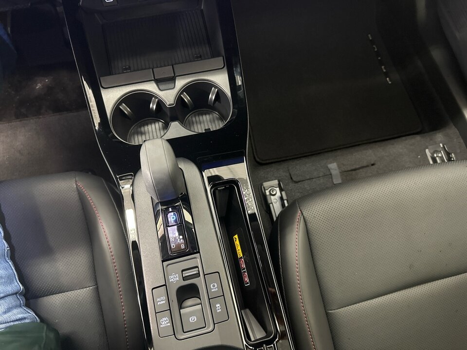

    I posted a little bit of the info in my introductory post. Basically, I bought a 2026 Nightshade plugin and got excited when I heard that the plugin had the charge mode option to force the engine to charge the battery. I understand its not efficient but great for people camping or doing hwy stuff and wanting to have a charge to do city driving(especially in the EU that have no ICE areas). I came here and looked but no one was really talking about it. So far it looks like its been completely removed and Toyota care says they dont know anything about it and cant find anything on the car manual. Amazing they seem not only to know nothing about it, but is unable to find out. Pretty sad.. Either way if people know a tech maybe there might be a way to enable it back again (holding down the ev/hv button for 5 sec). I just dont get why they would remove that in a mid cycle.

    Most likely its more then just a button but It would be nice to see a pic of a 2026 non-US version with it. If others around the world have it then it give me hope of a work around. Maybe they can enable it software wise at a dealership.. preferably one that knows there is a charge mode and what it is. Surprisingly many dont.
    As stated before I get the inefficacy part, but it leaves a bad taste having something that's been around (and still is in most parts of the world) yanked out at the time I get one. It feels like... a microaggression... lol

    Well one thing is for sure.. Its bugging me. Even though I would not use it much knowing everyone else has it but us is not sitting right.
    I looked up some 2026 for sale in Canada and boom.
    I must have it... somehow. I tried looking at a Toyota parts list for the button but cant seem to find the right one.. I assume its the same for the 2025s. Of course we dont know if its just a button but maybe if we can find out the button type it would help. Also it shouldn't be that hard to get access to the cable and try it. It would of course be great if there was a Toyota tech that could find out exactly what was done and if it can be brought back with a button or dealer program.
    On a side note: I dont know how I did it, but went to go pick up one of the kids.. went there in HV mode and parked, but left everything on while waiting. after about 10min..ish I stepped on the gas peddle once and the engine kicked on and ran. It kept running and I saw it was feeding the battery. I thought this might be a hack on having the engine charge it. I had to go so I figured I would test more later. Now when I try it thought it only starts the engine for a second and then shuts off since Im still in park..lol So there might be a work around, sort of, but not sure the right steps and also I would have to test to see how much its really pumping to the battery. It may be less then charge mode did.
