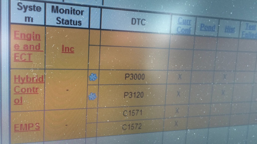

    Car won't start. Codes are p3000 and p3120
    Thanks in advance for putting up with one more thread for help before I tow somewhere.
    I had an old thread that got cumbersome (2001 shuttering to start, won't move in drive. | PriusChat) and I now have some cash to move forward.
    I've now added to minVCI and Techstream to my toolbox just to try and figure out what I need. A screen shot is attached.
    On my old post someone asked how to get the subcode. Can I do this with Techstream and/or what would some kind folks suggest next?
    iPhone ?

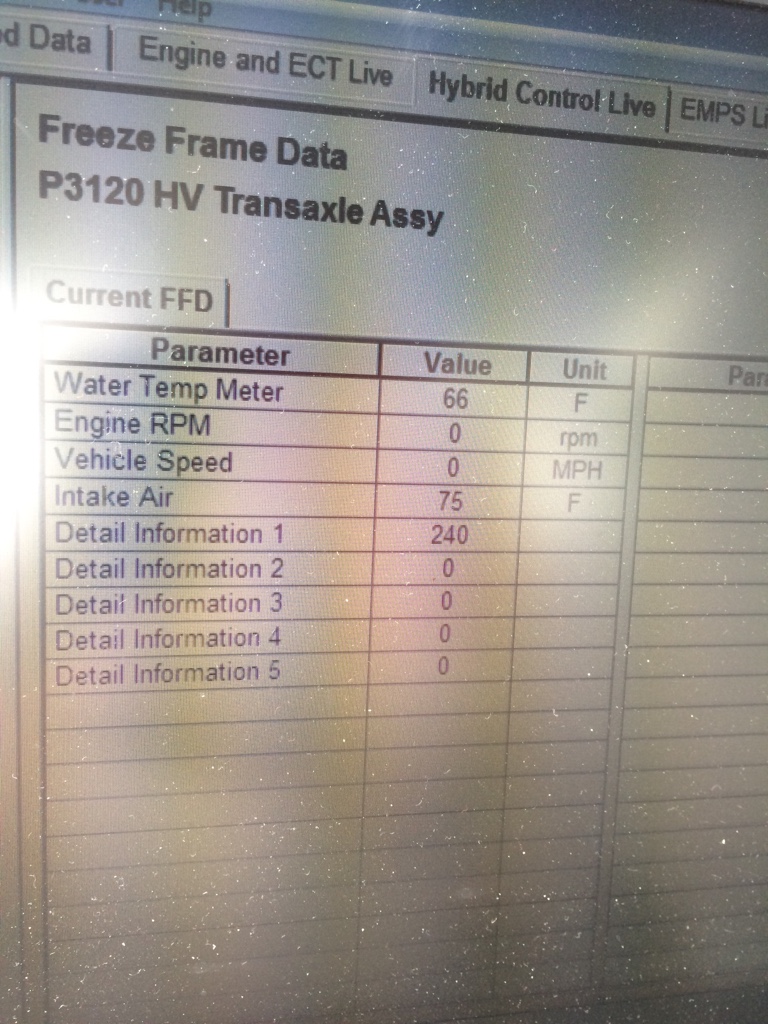

    I can't really help with much, but to answer this question, I believe you click on the "snowflake" to the left of those two trouble codes and it will take you to another screen which contains the sub-codes, and possible a whole lot of other goodness.

    The subcode is in the FFD (Freeze Frame Data) as what dolj pointed out.

    DTC P3120: your car's transaxle has failed.
    Info code 240 means that the generator is locked. Apparently there is a problem with MG1.

    Are you talking about this? I've already left the car [​IMG]

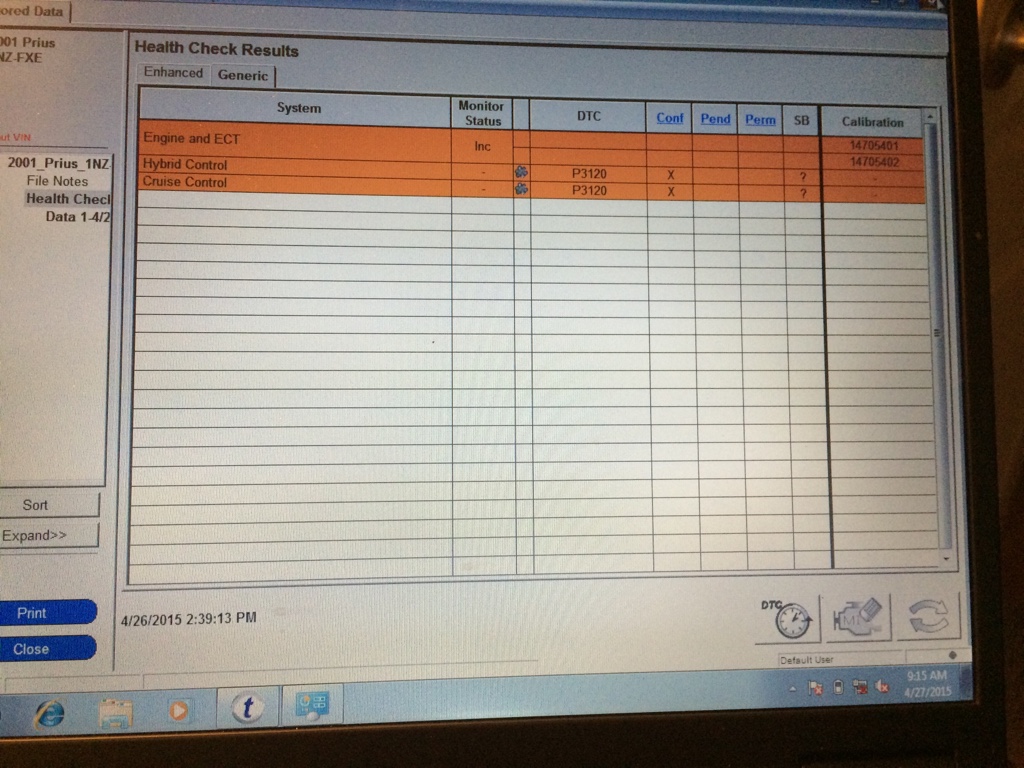

    Yes, but I think not all your data are showing. Perhaps you have set the filter at the bottom of the screen to Primary?
    If you have saved your data, you don't need to go back to the car to re-read the DTC and take photo. You can just reload the saved files and view the info.
    Inf code 240 means Generator locked but in your other thread, MG1 seems to be spinning. Since this Inf code is related to MG1, it is important to show all the data related to MG1.

    I'm using version 9.30.002 and don't have that pull down menu. Is there somewhere else in the menu I could indicate what you are describing?
