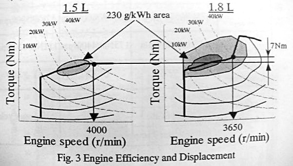

    How you drive absolutely matters in how long the engine will last (and how much carbon will build up). The prius engine is most efficient when putting out between about 12-33 KW (~15-45 horsepower) which is about the power output you'll get when driving in the top 3/4 of the "eco" range of the hybrid system indicator bar.
    That's the power output needed to accelerate moderately and/or maintain about 60-80mph on flat ground (windows up, no roof rack, only driver in car, etc). Anytime the engine is running outside of those zones, it is doing so inefficiently.
    Very slow acceleration is inefficient. Full throttle acceleration is inefficient. The engine idling to recharge the battery is inefficient. Inefficient operation will burn more fuel than necessary which means more deposits. The engine is especially inefficient when it is first warming up so if you combine the above operation with frequent short trips (lots of cold starts) you're far more likely to cause carbon build up.
    You're also more likely to have extra crap breaking down the oil which is why a car that spends a lot of time idling on & off battery in gridlock should change its oil every 5,000 whereas a car spending all its time at highway speed can do 10,000 mile intervals.
