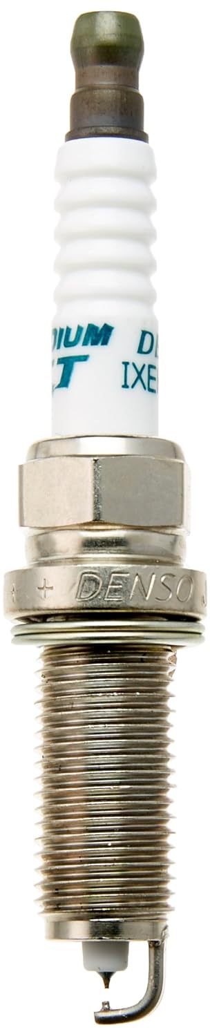

  16. ThatDudeOrion
    ThatDudeOrion Member
    Dec 2, 2016
    95
    87
    Central, NJ
    Not to be pedantic but that’s a picture of a different series of denso plugs. That’s an ixeh20tt, twin iridium tips, which I would have tried to get for my car but they don’t make it in a 16 heat range. The standard sc20hr11 and sc16hr11 only have a plain platinum ground as far as I’m aware.
    tvpierce likes this.
  17. StarCaller
    StarCaller Senior Member
    Feb 15, 2014
    1,284
    733
    Cedar Crest, NM, USA
    oops, I thought they were the same/
    that's the one I put in; works flawless/
