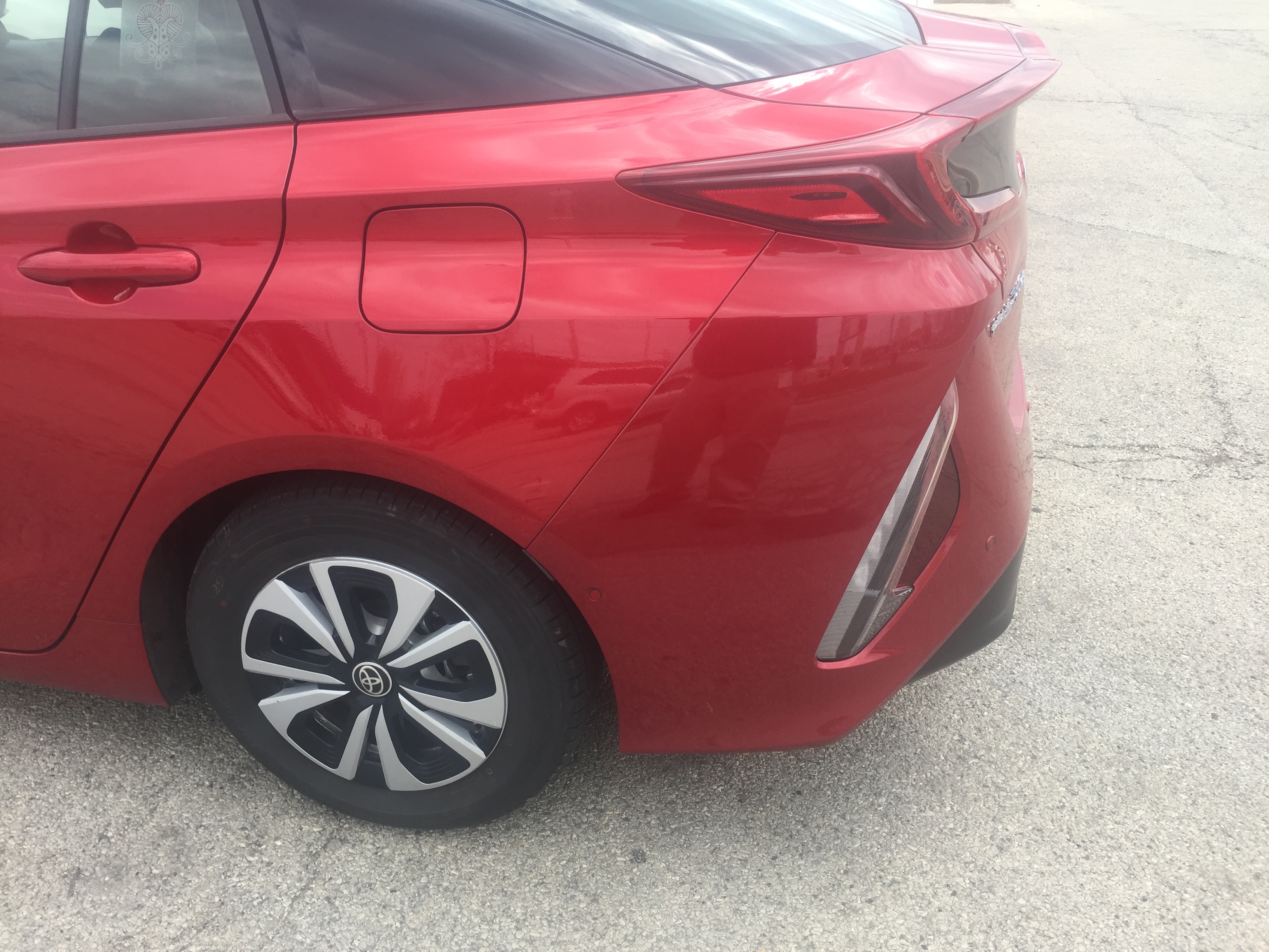

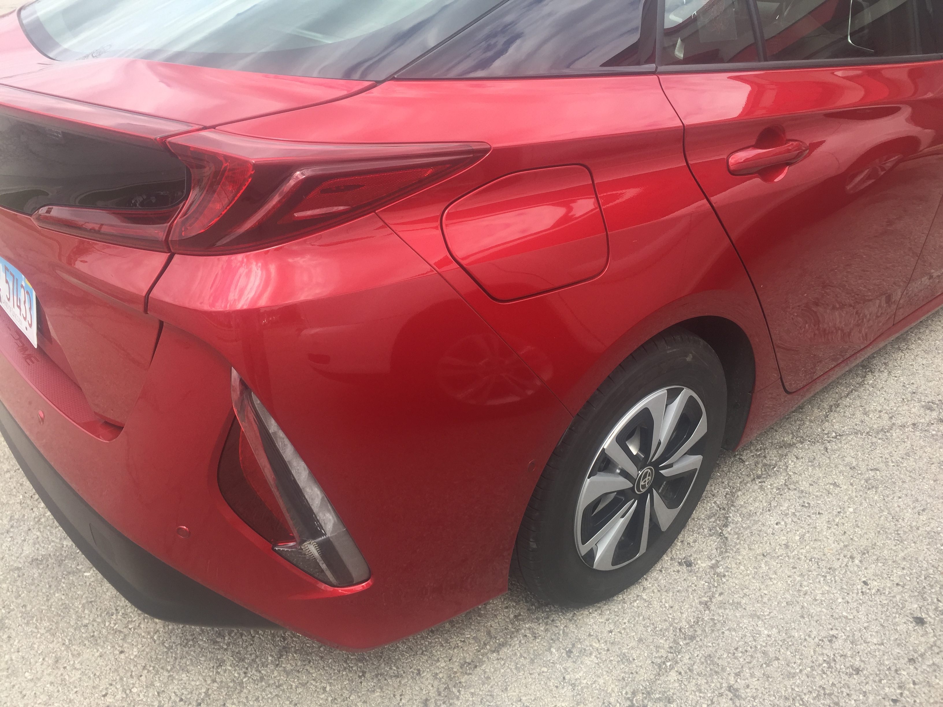

    well... just picked her up from the body shop...
    any comments on the paint job?

    Is that color mismatch or the lighting? The rear corners look darker then the side of the car.

    body shop guy says it is lighting... and that the corner is plastic and the part in front of that is metal...

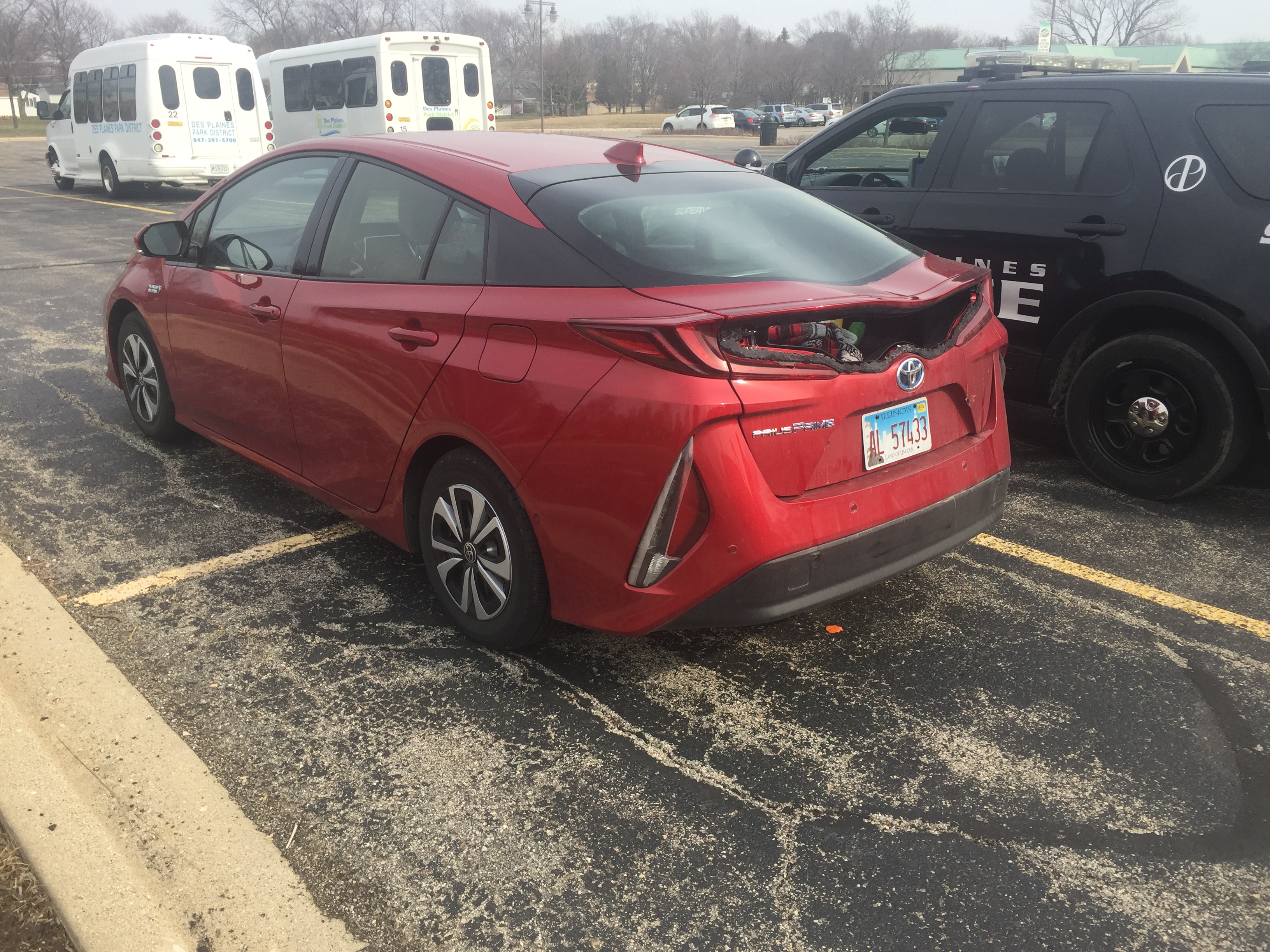

    here is a before photo:
    i also note that they have 'red metallic' as the color in the paperwork... it is actually 'hypersonic red'...
    he said they would re-paint it for me if i want... i wanted to get some other eyes on it...

    Nope, doesn't match. I know the cheap method is preferred to paint the bumper off the car in a room by itself and then attach onto the car. I always refuse that. I want it painted on the car to the right colour and faded/blended into the existing paint. A 2017 made in 2016 has a good amount of colour change in the paint on the rest of the car already, it just happens, it lightens over time. If you blend it properly, you won't notice.
    But that involves painting the bumper on the car. Which involves masking all the no-paint areas (i.e. high labour costs) and then for hybrids and EV's removing the battery so that the entire vehicle can be baked at high temp without degradation (i.e. high labour costs).
    There is the standard/cheap way and the pain-in-a$$-customer-that-wants-it-factory-perfect way.
    jerrymildred likes this.
  11. Tideland Prius
    45,326
    16,559
    The problem is the materials will have a mismatch in colour (I've never had any painting done on mine so it's all factory paint and I still see a colour difference at a certain angle between the plastic bumper and the metal body of my Gen 3).
    However, that does seem awfully obvious in the photo above. Hypersonic Red has 3 coats - base red pigment, titanium oxide coating then the clearcoat. It seems like they forgot the titanium oxide coating and all we're seeing is the base red paint.

    Doesn't look particularly good from the picture given (hard to tell, especially subtle differences). I'd ask for a repaint if it really looks that different.
    I personally disagree with 2k1Toaster because I really would prefer the body shop limit the work they do to the plastic pieces on the car - this goes double for the rear quarter panel which is probably the most expensive part on any car to get fixed. Note that what parts get fixed/worked on sometimes ends up on vehicle history reports and work on the rear quarter panels probably gets you more devaluation than a (relatively) simple bumper cover replacement (because it suggests much more severe damage).
    When I had to get a front bumper piece repainted multiple body shops did emphasize that the color on plastic pieces often look different than the same color on metal. The final job ended up matching well even under direct sunlight.

    It does look a little "off." Good luck trying to get them to redo it.

    Looks pretty bad to me. I think I'd want them to try again, especially since they offered to. But, even though feathering would be best, as pointed out, that's a lot more work with more opportunities to break something. Can't they test paint some scrap plastic, let it dry, and compare before doing the bumper cover? That probably won't be perfect, but it'll help them get closer without wasting too much time.

    That looks like they painted the bumper, right up to the seam, with solid color, then stopped. Which is not good, guaranteed to create an obvious color junction. The way to do it is to paint solid color for the whole repair area, then thin it (say 50%) with clear, spray a little further, think it again, spray a little further, till eventually you're spraying virtually clear.
    If the damage area was small, this blending process might have been possible within the confines of the bumper. If in fact what they've done to now is complete repaint of the bumper, solid color all the way to the seam, then the blending will have to be on adjacent panels.
    Addendum: Note in the second video, they purposely mis-match the color, and then show how blending in can remedy this. As you walk around a car in any lighting, there will be transitions in hue. Blending the paint is a bit of smoke-and-mirrors: mimicking an actual hue transition.

    I think the shop used Barcelona Red instead of Hypersonic Red.

    Barcelona Red is 3R3
    Hypersonic Red is 3T7
    Ask them what colour code they used. Also, whether there's the aluminium reflective layer added beneath the base colour.
