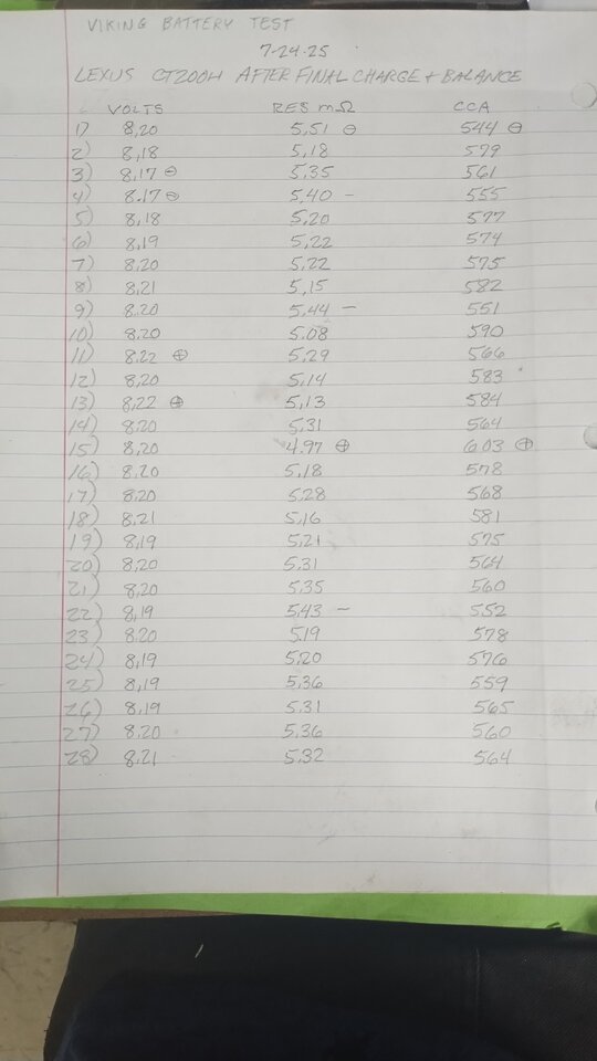

    I'm still learning how to identify bad modules.
    I cleared the P0A80 with a generic code reader and by disconnecting the 12V small battery, it keeps coming back
    The Delta SOC was 40
    All three cycles the battery was charged to 237V - 238V
    I had the metal cover off and a box house fan on top running on medium for the entire process
    The before charge-discharge-balance volt test showed a .05V difference between high and low modules. (Picture on my post #36 above)
    The after charge volt test also shows a .05V diff between high and low modules. (pic attached)
    Haven't done a volt test after discharge, will do so. So any module that is lower than .03V from the highest module is suspect bad?

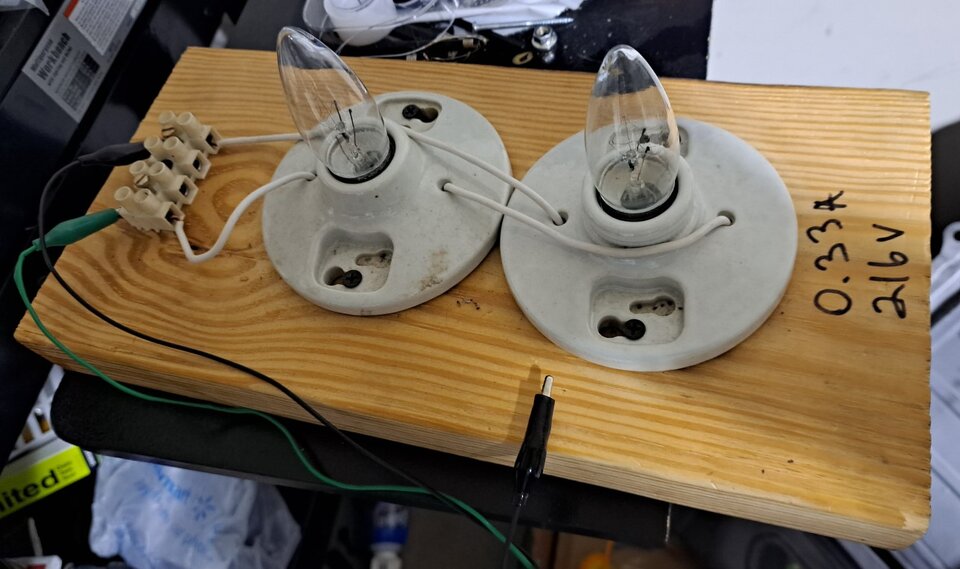

    You are in a situation that has already been discussed here on the forum years ego. The Hybrid Automotive's method of discharging the entire battery to 84 volts will not fix the P0A80 code. There are several weak cells in a few modules in your battery that won't recover until you discharge the whole battery below 84 volts. The battery with 125k miles is unlikely to have dead modules that can no longer be recovered. A situation with 3 bad modules, with code P0A80, occur closer to 200k miles on the 2010 prius.
    I would do one cycle by discharging the entire battery to 3-5 volts and then discharging it on the car to 40% and checking the voltage of each module after 10 minutes if the voltage does not vary more than 0.03 volts. The discharger can be assembled, as in my photo, from 40-watt light bulbs.

    Are the 2 bulbs 120V?
    And wired in series means each bulb is getting 120V when the battery is at 240V?

    Each bulb is 120V connected in series = 240V.
    You can use higher wattage bulbs to raise the discharge amps, but to restore the capacity, you need to discharge it with a low current, as scientific sources say.
