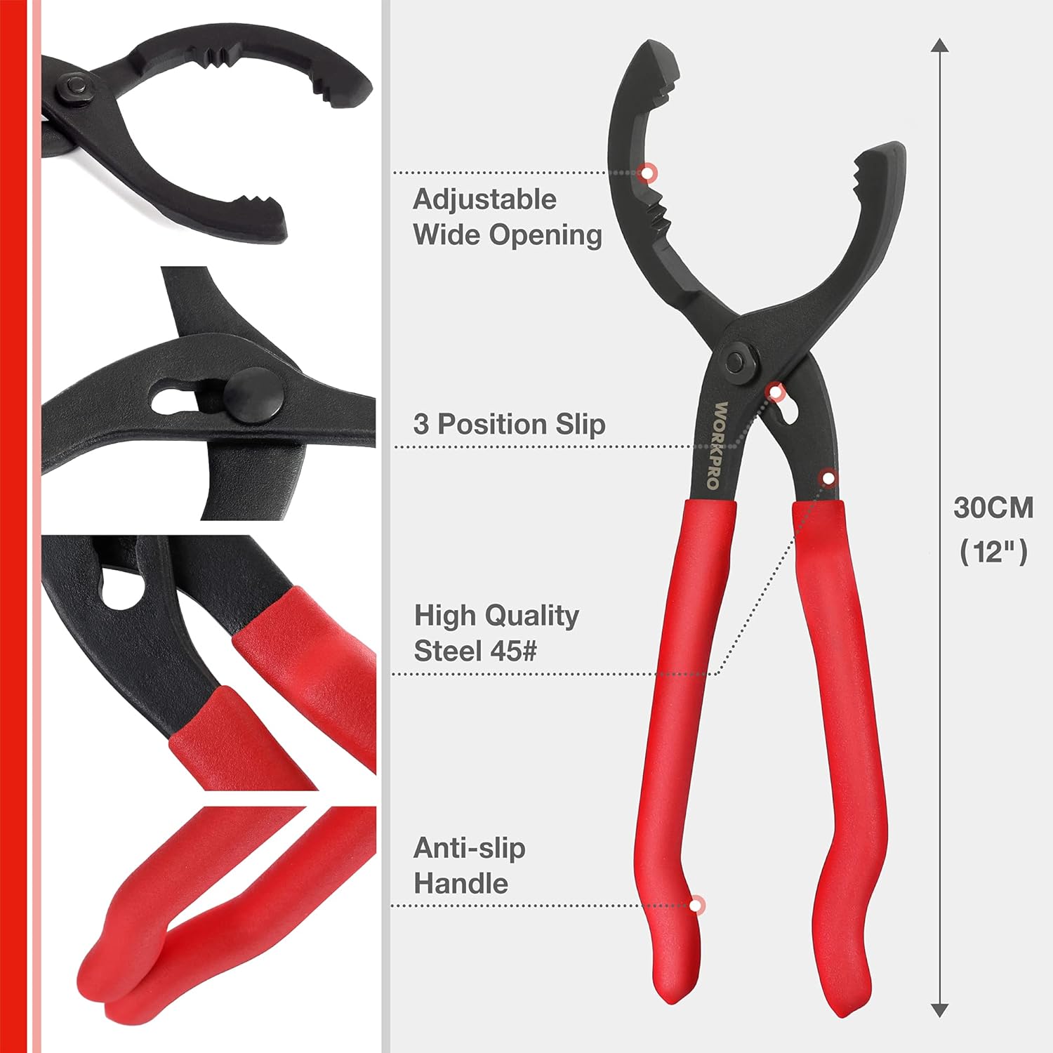

    Spin-on oil filters should never be installed with a wrench! They should always be only hand-tightened. Just make sure that you have approximately achieved the required number of turns (typically 3/4) written on the oil filter while applying a firm pressure with your hand, preferably using a paper towel or glove. That is what happens if you install them with a wrench—you can’t remove them—as they always self-tighten over time.
    I understand that at the factory, hand-tightening them is not practical, as they don’t want the workers to have overuse injuries in their hands and wrists.
    As for removal, this will definitely work. You can also get it at any auto-parts store. Don’t use it for installation though, as for the reason I explained above as well as it will impress teeth marks and/or cause deformation on the oil-filter case.
    WORKPRO 12” adjustable oil-filter pliers on Amazon
