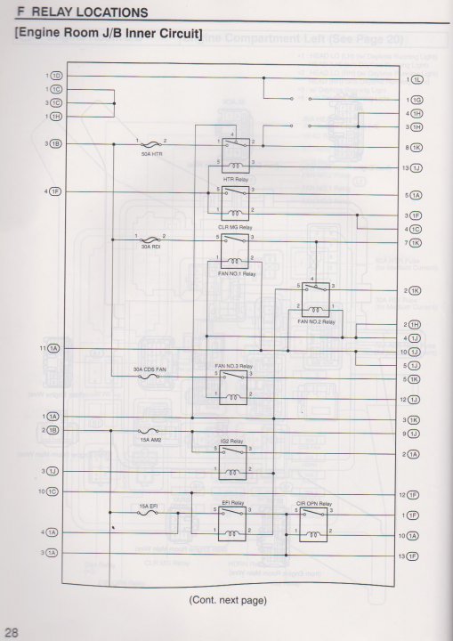

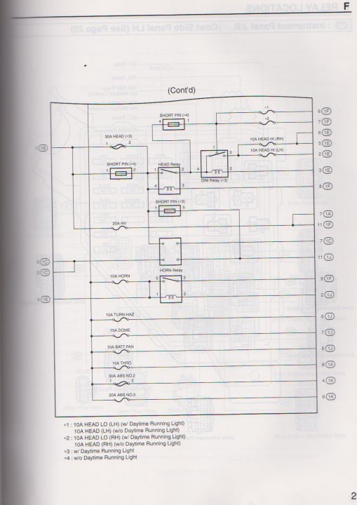

    Denis,
    Here are the relays and fuses, I hope this helps.
    engine wiring.jpg engine wiring.jpg instrument wiring.jpg instrument wiring 001.jpg

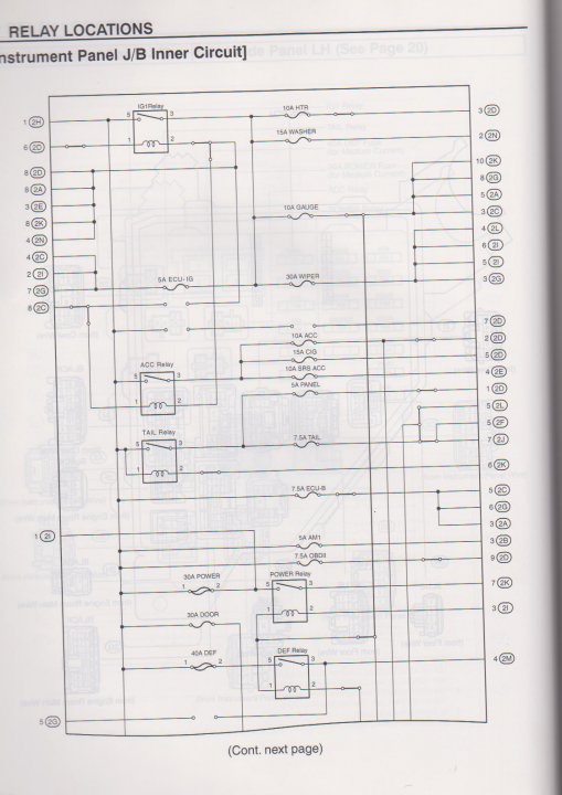

    oops here is the page that should have been with the first one
