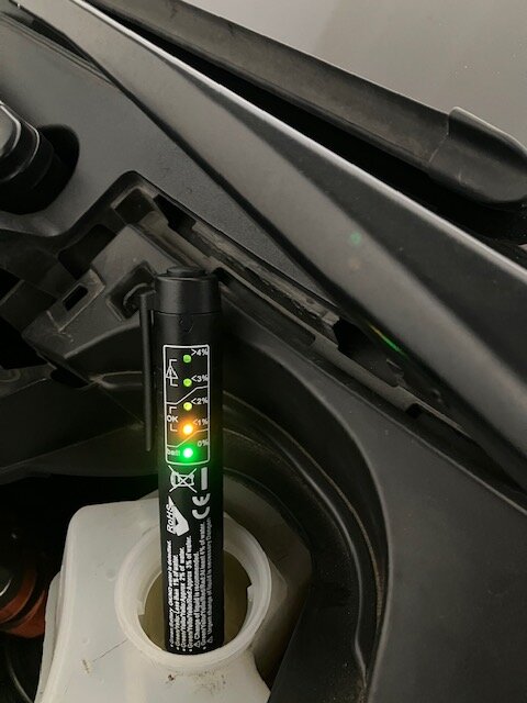

    I splurged on the $13 tester.
    Wife has the Prius out of town just now so I can't take a reading but I'll see what it says next week.

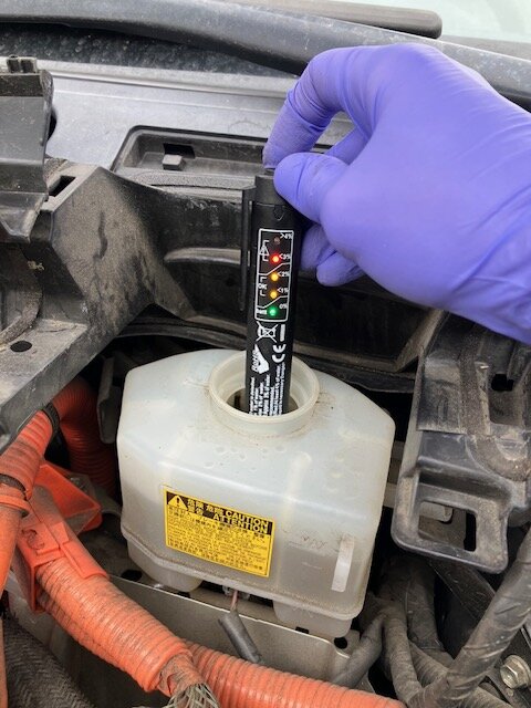

  4. pasta4breakfast
    Mar 8, 2020
    131
    67
    Anaheim, CA
    2020 Prius Prime

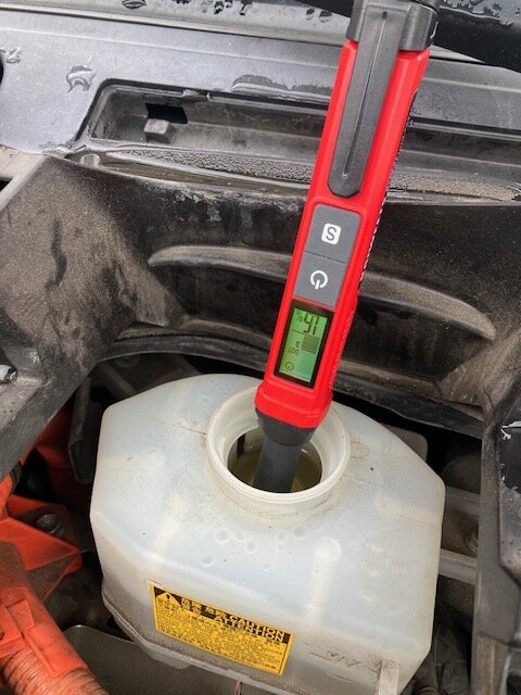

    Unfortunately I just tested the 7 year old brake fluid in my 2013 prius C again with the same product and it is now saying it is 2% water. I don't see how it went from 2.5% water 4 months ago to 2% water today. I guess it says the error range is 0.3%, so if the fluid was truely between 2.2 to 2.3% water both times, both tests could have been valid. However, I am a little suspicious because I have had this problem with other testser showing lower % water over time on the same fluid.
    I am planning to get the fluid replaced this Saturday. That is why I tested it today. I wanted to get a test done within a few days of the replacement, so I could test the new fluid compared to the old fluid.

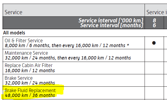

  8. Mendel Leisk
    61,554
    42,354
    I've never weighed in on this. Regarding the title question: somewhere around model year 2014 Toyota Canada began saying to replace brake fluid every 48k kms (~30k miles) or tri-yearly, whichever comes first.
    (Toyota Canada Maintenance Booklet excerpt attached)
    OP says dealership asked for $300 USD for this service. That's mildly preposterous; $100~150 USD would be a fair price. That's the going rate in Canadian funds up here, lol.

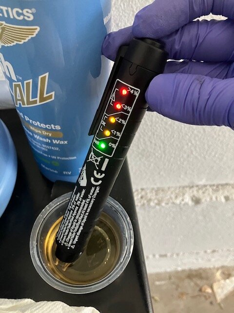

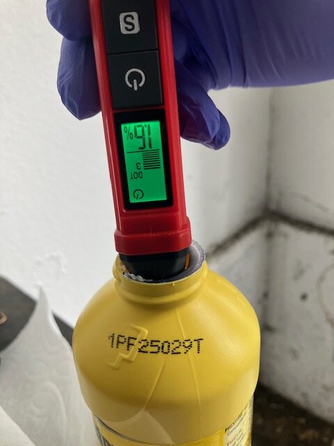

  10. pasta4breakfast
    Mar 8, 2020
    131
    67
    Anaheim, CA
    2020 Prius Prime

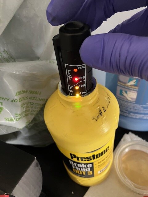

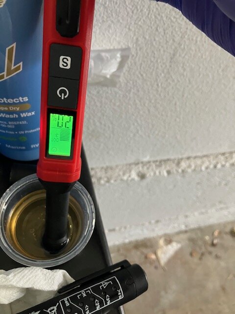

    Maybe, or maybe these testers just aren't that reliable. I also wonder if different additives used by different brand brake fluids interfer with whatever process these cheap testers are using to measure the percent water.
    Here are the test results on the new (sealed) bottle of brake fluid just opened today. As you can see, the other pen brake fluid tester aslo said this bottle had as much or more moisture than the old brake fluid. This pen also had the same issue at one point. It detected less moisture in the brake fluid over time. I think there is more likely to be a problem with these testers than the sealed bottle. I think the brake fluid production date was 1/29/25 based on the stamp towards the top of the bottle on the image below. As expected, there was no copper detected via the test strip.
    Here is the result of the original factory filled brake fluid in my 2020 Prius Prime with the other pen tester. I forgot to get a picture with the tester OP bought, but it was 1.6-1.9%
    Here are the results of my 7 year old brake fluid in my 2013 Prius C. It was replaced at a dealer in 2018 and they used valvolene fluid.
    Here are the results of testing 21g of the same Prius C brake fluid I mixed with 1/8 tsp of water of water in a pastic disposable cup and stored in my garage for over a year. These are the little cups used for dressings and sauces when you get food to go. The lid was definately not air tight.
    #30 pasta4breakfast, May 4, 2025
    BiomedO1 likes this.
  11. pasta4breakfast
    Mar 8, 2020
    131
    67
    Anaheim, CA
    2020 Prius Prime
    I contacted Prestone to see if they could provide any more insight. They confirmed your statement about the % water in unopened brake fluid, as well as my suspicioun about the accuracy of pen brake fluid testers in general. See their statement below
    "Those Brake Fluid moisture testers are highly in accurate. The Prestone bottle you mentioned was produced on the 29th day of 2025. All Brake Fluid productions are thoroughly tested to ensure moisture is below 0.1%. We have tested many different types of % moisture testers and historically they have not been accurate. I am not sure what is causing the inconsistencies. If you are looking for a more accurate way of measuring Brake Fluid life we would have you get Brake Fluid Boil Point tester. These are found to be more reliable but can cause some false readings too."
