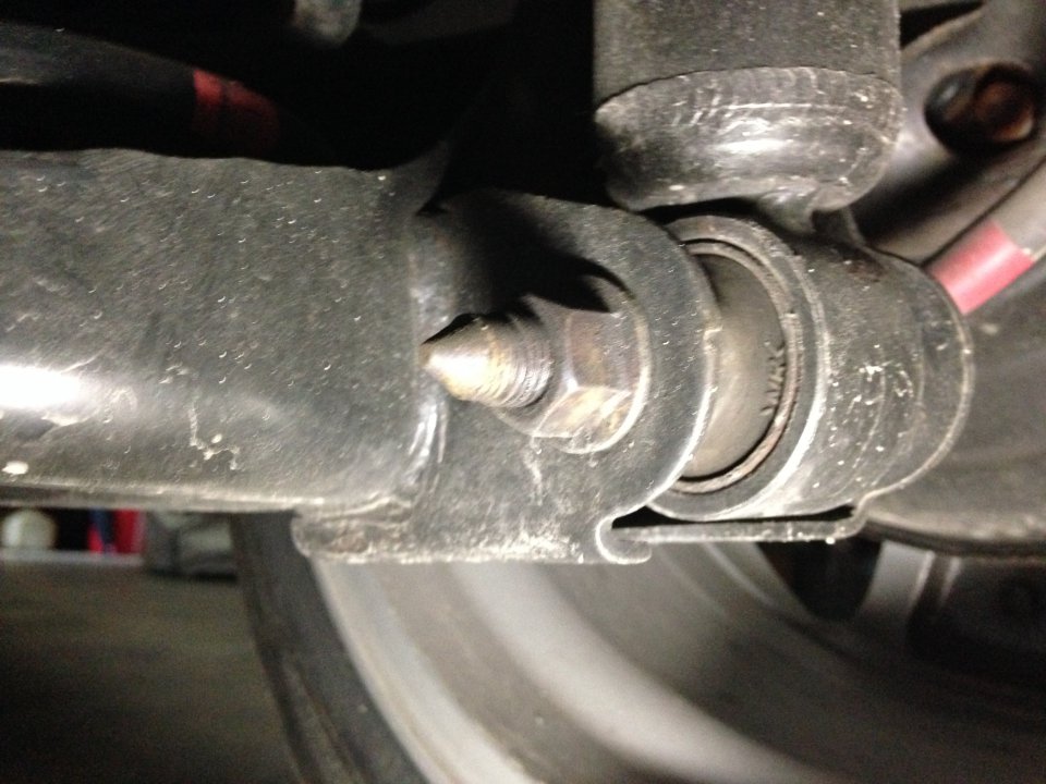

  8. Georgina Rudkus
    Georgina Rudkus Senior Member
    Sep 15, 2018
    3,576
    2,605
    Taylors, SC

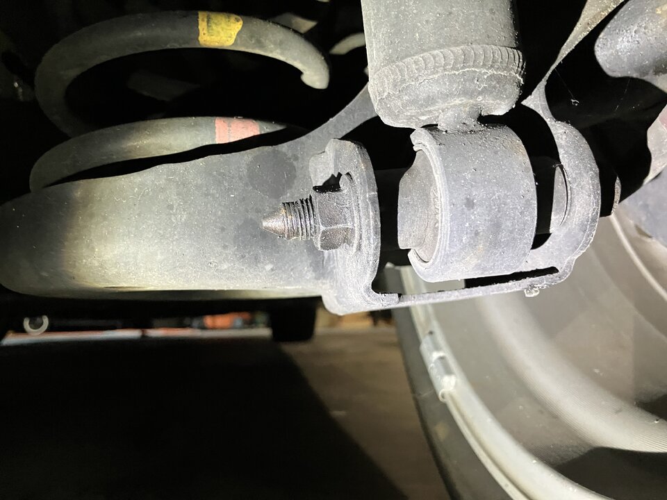

  9. Mendel Leisk
    61,591
    42,369
    Another 6 years, I might have touched it once, losing track: IMG_1948.jpeg
    mjoo likes this.
  10. Mendel Leisk
    61,591
    42,369
    The trailing arms are likely more crusty, they’re covered in plastic, harder to get to.
