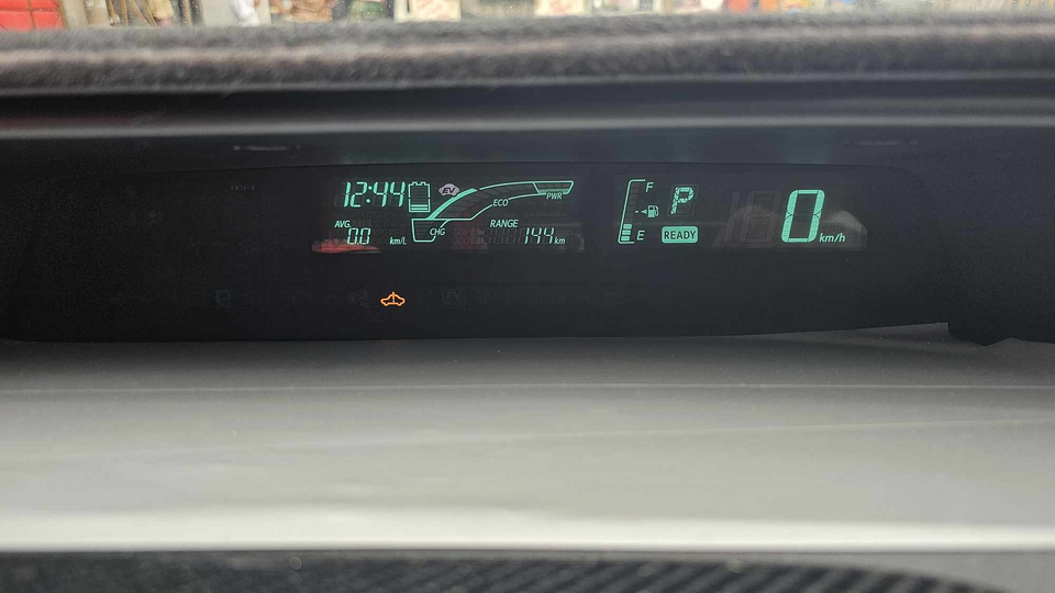

    One of my friends has got the following check light on the cluster.

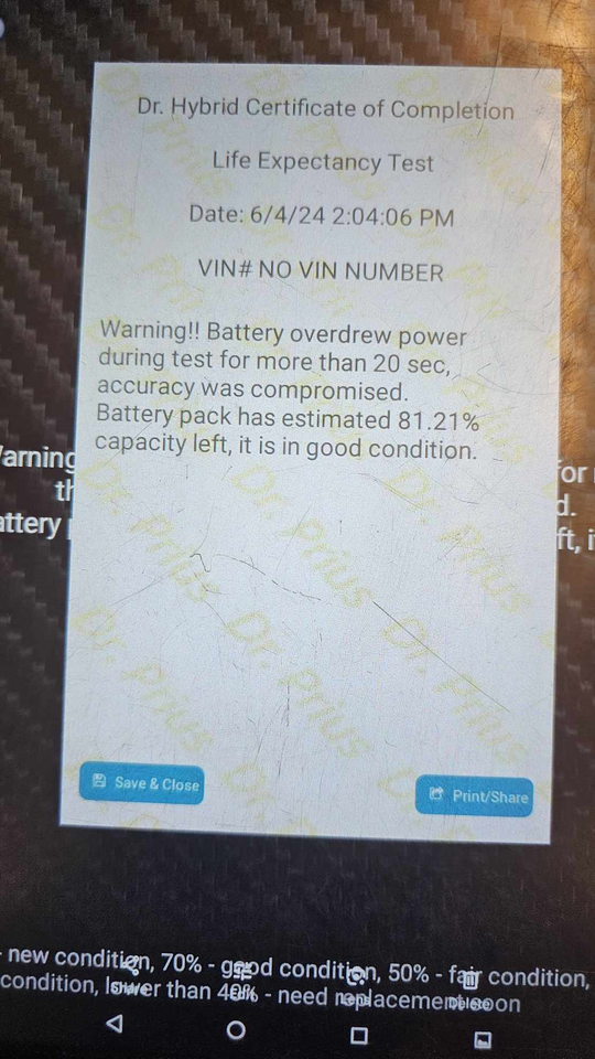

    After scanning, it is the infamous 'PA080 Replace Hybrid Battery Pack' code. However, the battery health was tested immediately afterward, resulting in an astonishing 81% SOH.
    I do not put my utmost confidence in Dr. Prius here since the result indicated that it could be wrong.
