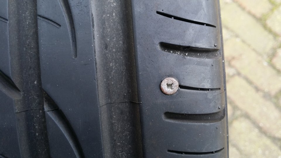

    Just wanted to replace my winter tires. See what a nice surprise I've got here.

    Pro's will probably tell you that's too close to edge. I've plug repaired very similar to that, worked out fine.
