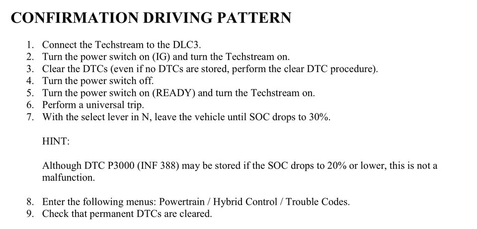

    Well, to be clear, every trouble code that can be stored as 'permanent' has a specific Confirmation Driving Pattern all its own. The Confirmation Driving Pattern is shown in the pages for that trouble code.
    Most confirmation driving patterns have a Universal Trip as one part of the whole pattern. Because that shows up as part of the confirmation driving patterns for many different codes, it's described just once toward the front of the section, instead of repeated for every trouble code.
    But it's usually just one part of the whole confirmation driving pattern. To make a permanent code go away, you have to complete the whole confirmation pattern that's laid out for that specific code. (And the problem that the code indicated has to not be a problem anymore.)

    Back a month ago in this thread the entire confirmation pattern was discussed including the fact this particular one effectively stress tests the battery to pass.
    Dreaded P0A80 Code - Car Running / Charging Good. | Page 3 | PriusChat
    Then the issue became following the steps accurately followed by how to do one of those steps, eg the Universal Trip.
    After a few failed attempts he elected to try multiple drives.

    Remember to do not just a Universal Trip, but a Universal Trip at the right point in the full confirmation driving pattern for P0A80.

    Well as mentioned before ill be doing this with my scanner and not techstream as I do not have it and just to confirm again, step 6, is the universal trip (drive at 25mi for at least 10 min) done driving while car is in Maintenance Mode?

    Do not drive in maintenance mode, it's only for testing.
    Toyota tells you not too.

    Well at least with the Autel based OS I cannot clear codes since there are no current to clear. When I tried the confirmation drive the 1st time that is what I mentioned, no option to clear. I can try with the blue driver and see if it gives me the option, but in case it doesn't then does this confirmation drive only apply to vehicles with current codes?

    I will find the video as well as the post where I read the universal trip was suppose to be done in maintenance mode. This confimration thing has been confusing, everyone has been posting the same info as I did in post #95 which is what I followed to the T in my 1st attempt obviously minus the “clear codes” part since I dont have any current codes and scanner does not give option to clear something that isnt there. The instructions say. “clear even if no DTC’s are present” but perhaps thats a techstream option only?
