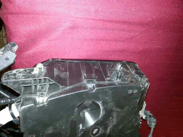

    I am stuck on removing the bottom bolt on the fuse box. It is covered by a plastic piece that I can't figure out how to remove. I have to get the bottom/third bolt out in order to slide the box in the direction of the passenger side as the two pins that sick in the fender are connected to the mid/main section of the box that I need to lift up. It is so crowded with hoses and wires I may need to purchase the little cover to find a way to remove it without breaking it.
    To be continued.....

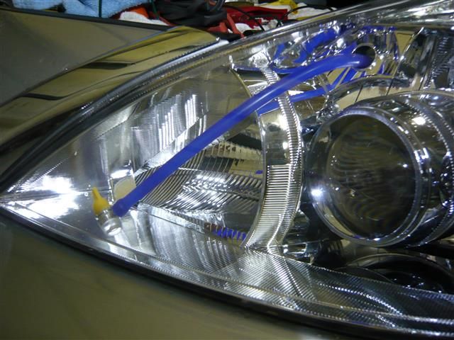

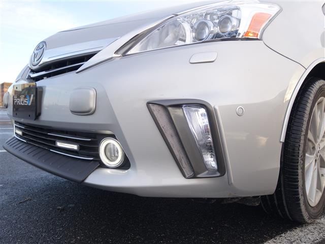

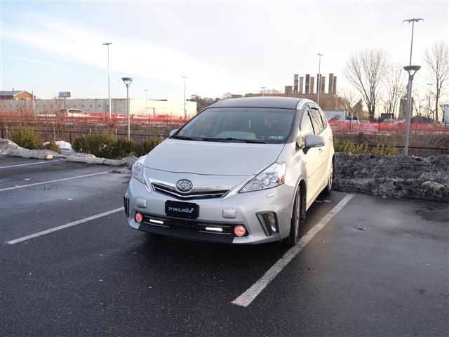

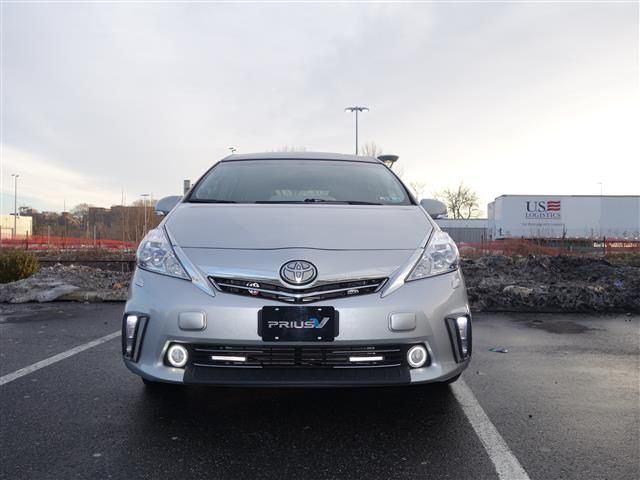

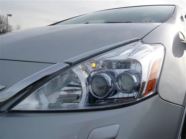

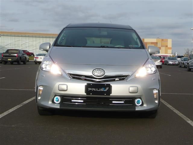

    My DRL to the max!
    @@@ DYI: Add DRL to stock turn signal @@@ | PriusChat
    The Philips DayLightGuide is a very bright white "band" not dots.
    Buy the Philips DayLightGuide LED Daytime Running Light 12825WLEDX1 LED Daytime Running Light
    The Philips will dim when the head lights are ON.
    The stock tiny DRL bulbs inside the headlight were replaced by the amber LED and the connections were replaced with the turn signal.
    The stock fog lights that I never used were replaced with the multi-color LED with remote.
    I normally choose either white or amber, otherwise the police may stop me.:oops:
    The eagle eye ones are not of high quality, so I made another sets with extra lens covers and water proof to be installed as soon as this set gave up!

    Wow, that is a lot of lights! There are so many there I actually got a little confused as to what you were referring to in your notes. So the eagle eye/halo lights are still there with the multi-color LEDs in the center? Were you able to get the bulb out of the headlight? My son has a "rubber" pencil that bends and contorts in all sorts of shapes. If that happened to me I'd "borrow" it and wrap masking tape on the eraser, slink it in there and try to stick the tip and pull it out. (I'm sure it'd be a nightmare of a job.) For other vehicles putting the housing in the oven for a little seems to loosen the glue that holds the pieces together. (I've never done this personally, but I heard it works.) The halo lights look pretty bright compared to the Philips in the first picture. Maybe they don't look as good from an angle? It's strange but seeing that another person had an issue, (as you have dropped the bulb inside the light,) has given me some motivation to pick up where I left off...
    But, I may just give up. As I started I WAS thinking I could lift up the front of the fuse box 90 degrees to be able to work underneath since the rear of the box has a huge harness coming out of it, and another on the side towards the rear. I don't want to move the large harness much, but I've realized that the harness coming out of the front may/will hinder me doing that. I don't want to be messing with what's underneath without a good view of what I am working on, as there are a lot of wires underneath there. As the car sits in it's current state I may start to forget how to put things back together. (I took a picture to help remind me of where things go, but still.) I haven't even opened the used Canadian Prius v fuse box that I got. The good thing I noted from that is that all the wire ties can remain intact and you can separate the middle from the bottom without cutting any of them. For the Prius c fuse box I got last year I had to clip at least one of the wire ties, but that is probably one of the least of your worries anyways.
    On the side/As a possible alternative I have been interested in the Sylvania ZEVO FOG Daytime Running Light unit from here:
    Functionality wise I think they would be comparable to the Philips you have installed, meaning they auto adjust/turn off when you turn on your parking lights or headlights. This is a plus to me. I can only find them on sale outside of the US, and I'm not sure I want to be dealing with that. (Supposedly they are to be sold on amazon.com but so far not yet.) My main concerns are:
    Will it fit in the place of the stock fog lights without having to modify the mounting, ie. can I just take out the original fog lights and the unit will fit and I just screw it in? I found doing some digging that the ZEVO units seem to be 90 mm diameter. I don't know about the stock ones, but you still have to worry about the position of the mounting tabs/holes.
    Will it cause a bulb out error in the car as the fog light bulb will switch from incandescent to LED? (I'm assuming you may have encountered this as you've replaced your stock fogs with LEDs?)

    Wow, that is a lot of lights! There are so many there I actually got a little confused as to what you were referring to in your notes. So the eagle eye/halo lights are still there with the multi-color LEDs in the center? Were you able to get the bulb out of the headlight? The halo lights look pretty bright compared to the Philips in the first picture. Maybe they don't look as good from an angle? It's strange but seeing that another person had an issue, (as you have dropped the bulb inside the light,) has given me some motivation to pick up where I left off...
    Sorry for late reply:
    As soon as I realized that the bulb dropped inside the headlight, I knew it'd be a task to get it out. After some thoughts, I came up with the idea as seen in picture above: the rc car fuel tubing with magnet attached to the end! I only had to spin the tube a little to catch the bulb and just gently drew it out. ;)
    Yes, the halo lights are supposed to be installed "inside" the headlight for environment protection but I had another set which I put the sleeve over and silicone seal (yes they make the sleeve for the halo light). So for now the halo lights are outside around the multi-colored ones.
    Not so and that's because I set it up in such a way that if and only if the Philips lights are ON by itself, it will be at full brightness, but if any another lights come on, the Philips will be dim.
    #77 tanasit, Jun 19, 2014
    jzchen likes this.
