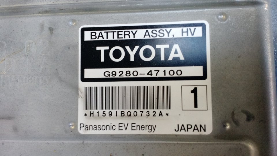

    PriusChat member "Dodge Aries K"(DAK) bought a battery from a seller called "Elite Auto"
    They regularly advertise on Craigslist.
    In the ad, and verbally, Elite Auto gave the impression that the customer would get a 2009 battery with only 29,000 miles on it.
    After inspecting the battery, I can guarantee that is not what Elite sold the DAK!
    Here are some pics from inside the battery.
    The "I" of the serial number shows it is from a 2005

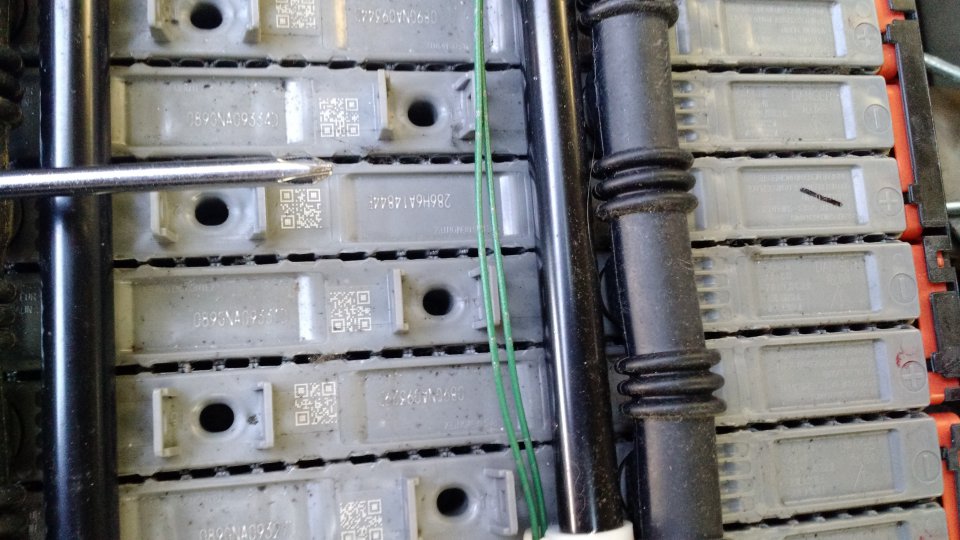

    Opening up the case it was obvious one module was different than the rest, also it had a black mark on it that made it stand out even more.
    Most modules had these numbers on them 089GNA09XXXD ("X" being a number 0-9") The letter "G" in the sequence means the modules were manufactured in 2005
    Except the oddball which was 286H6A14844E
    The letter "H" in the sequence means the module was manufactured in 2006.
    Clearly a module from a different pack
    Additionally, beginning in 2007, Toyota started adding additional codes (B2, B3, B4, etc) to the coding on the modules. You'll notice that none of the modules in the pack that Elite Auto sold have B2 stamped on them. Therefore, not only are these not 2009 modules... they are pre-2007 modules!

    Would you be able to provide Priuschat members with the identifying information of when the battery packs were built? Ex. the serial numbers in the case and module serial numbers that contain that information?
    edit: I figured out the information on the case serial, "I" is from 2005 and "J" would be 2006 and so on. Great. Thanks
