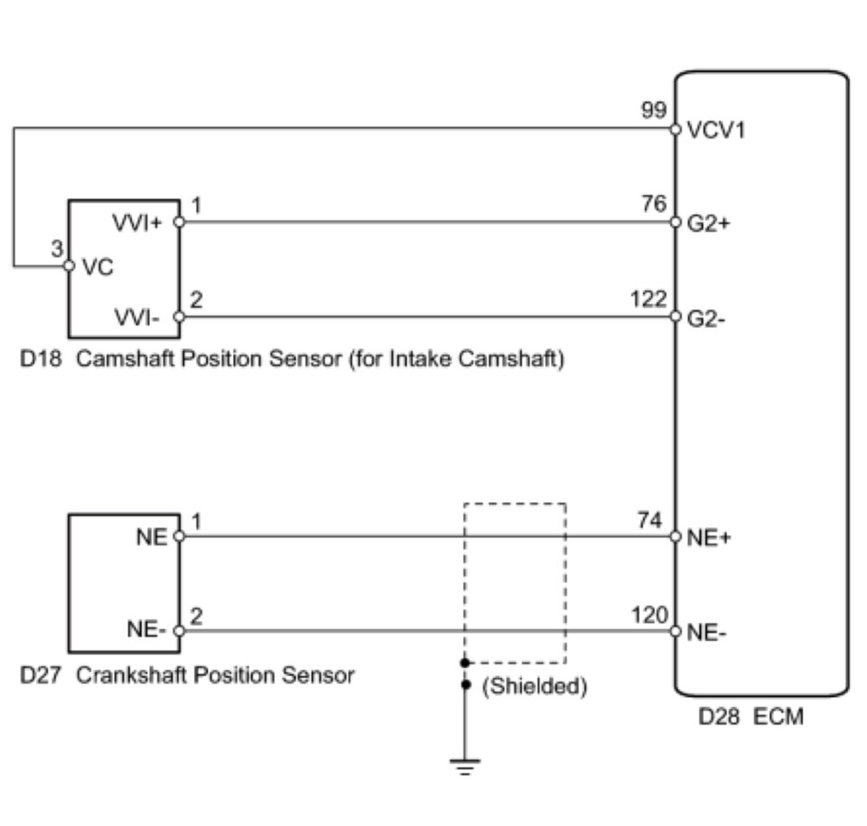

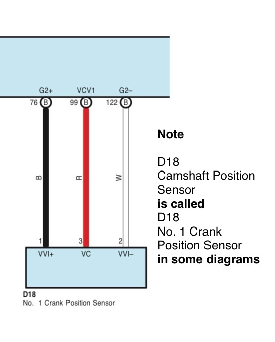

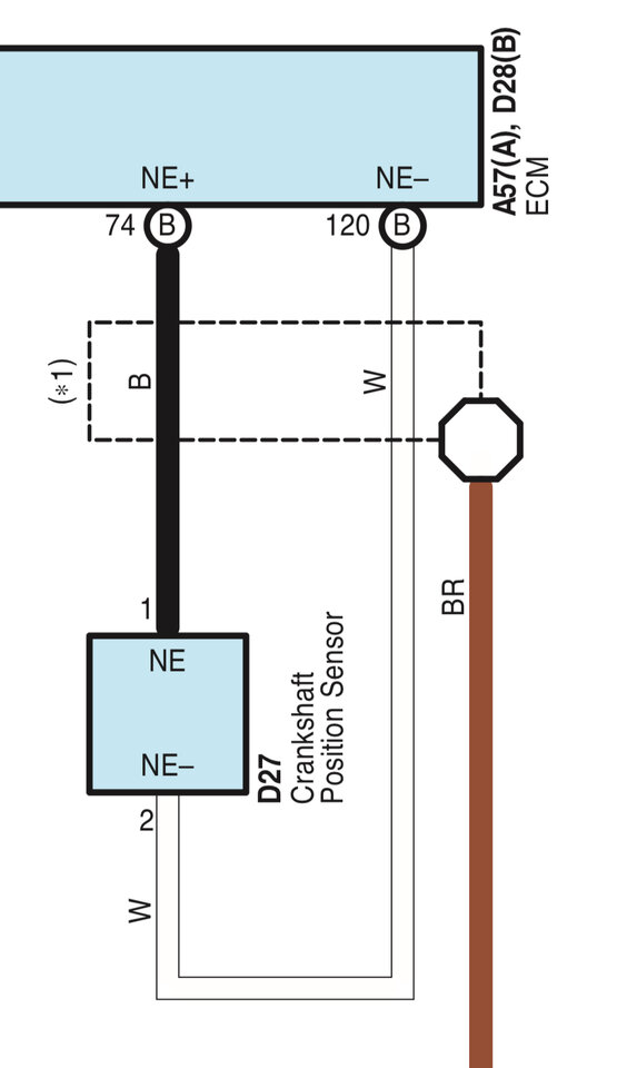

    I purchased a new cam subassembly, tore everything apart, changed out that sub-assembly, triple checked the timing, rotating the intake cam with the tensioner engaged 7 times to make sure the timing marks still lined up (they did) and put everything back together.
    Engine now shakes even worse. I have codes for misfires for every cylinder, an error about the cam sensor circuit being open, even though the cam sensor is plugged in and errors for every ignition coil. I just can't seem to catch a break. Any ideas what's causing all of that?
  18. ChapmanF
    28,621
    18,954
    oldzebra likes this.
  19. oldzebra
    oldzebra New Member
    Sep 26, 2025
    20
    Pacific Northwest
    I'll start there, thanks for the suggestion.
