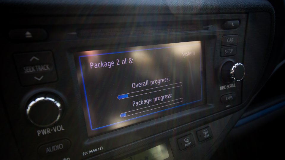

    I downloaded the swdl.iso file...will update soon. Thanks for the great thread.

    I used the link to update to Entune 3.2. It seemed to work okay.

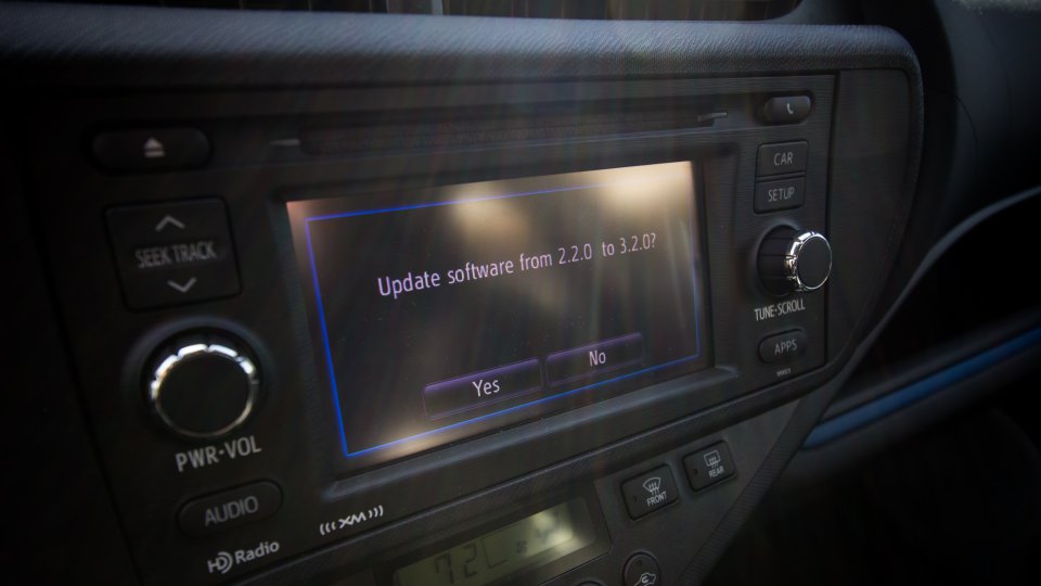

    I will update to 3.2 today - going to 3.1 caused one irritating new thing - if I am streaming from bluetooth, shut off the car, the next time I restart the car, the first time I switch the radio input it works for a few seconds and then switches BACK to bluetooth. Hopefully 3.2 fixes that...

    Thanks for this, updated mine and it works great! Much better touchscreen.

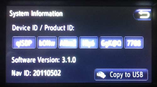

    Cool, I just upgraded from 1.8 to 3.2. I didn't have time to play with the update yet, but will in the days to come. I'm hoping that since I had such an old version that 3.2 will be much faster and improve the voice navigation which never quite worked correctly. According to the fixes compiled by Erica for 3.1, it should be quite an improvement! I saw in that other thread that some were complaining about the night mode for navigation being unreadable, but on 3.2 I was able to read the map well at night, but I'm not sure if it was in night mode are not. I never saw a night mode in version 1.8, but I never looked for it either. Day mode looks fine at night IMO.

    What does "Copy to USB do?"
  15. W5JCK
    W5JCK Junior Member
    Aug 9, 2013
    32
    Arlington, Texas
    I didn't press the Copy to USB button, but I assume it will copy the Device/Product/Nav ID numbers to a text file on the USB drive so you don't have to write them down on a piece of paper. That would be helpful if you wanted to give the ID's to say SiriusXM to activate your satellite radio, or to Toyota Customer Service if trying to resolve an issue.

    All it does is save some personal settings; I haven't tried it myself, but here's someone who did:
    Entunes Update Arrived, my findings.... | PriusChat

    Ok, just copied the files to a USB stick, but have not renamed anything to 14A. Is it critical to rename the USB stick to 14A? Or can I just copy the files and load them into the car? Thanks in advance.

    Just update from 2.1 to this 3.2. Then I read it is not for the PREMIUM had. I have a prius IV. Everything seems to be working. Did I mess anything up?
