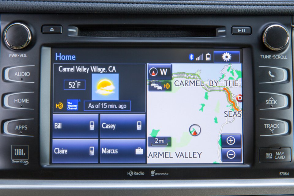

  17. ROLOPR
    ROLOPR Member
    May 22, 2012
    441
    95
    Puerto Rico
    I love the way Entune looks now on the 2014 models (3-way split display as example) I hope this version can be incorporate to older entune radios.
    images.jpg I know one thing is the home button and the maps now are in a memory card, but the display can be corporate via firmware, who knows.
