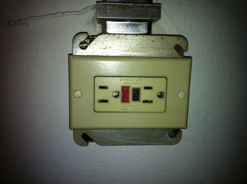

    Is there any way to tell if this power oulet in my garage is 110v or 240v ? I have been using it to charge my PIP with facotory EVSE for about 1 year. I would certainly do the upgrade if this oulet is 240v. Thanks

    It's almost certainly 120 volts, unless someone wired it wrong. Tesla Charging | Tesla Motors has some examples of 240 volt outlets. It isn't complete though, even for the US.
    If it ran at 240 volts, your L1 EVSE would have been fried by now.
